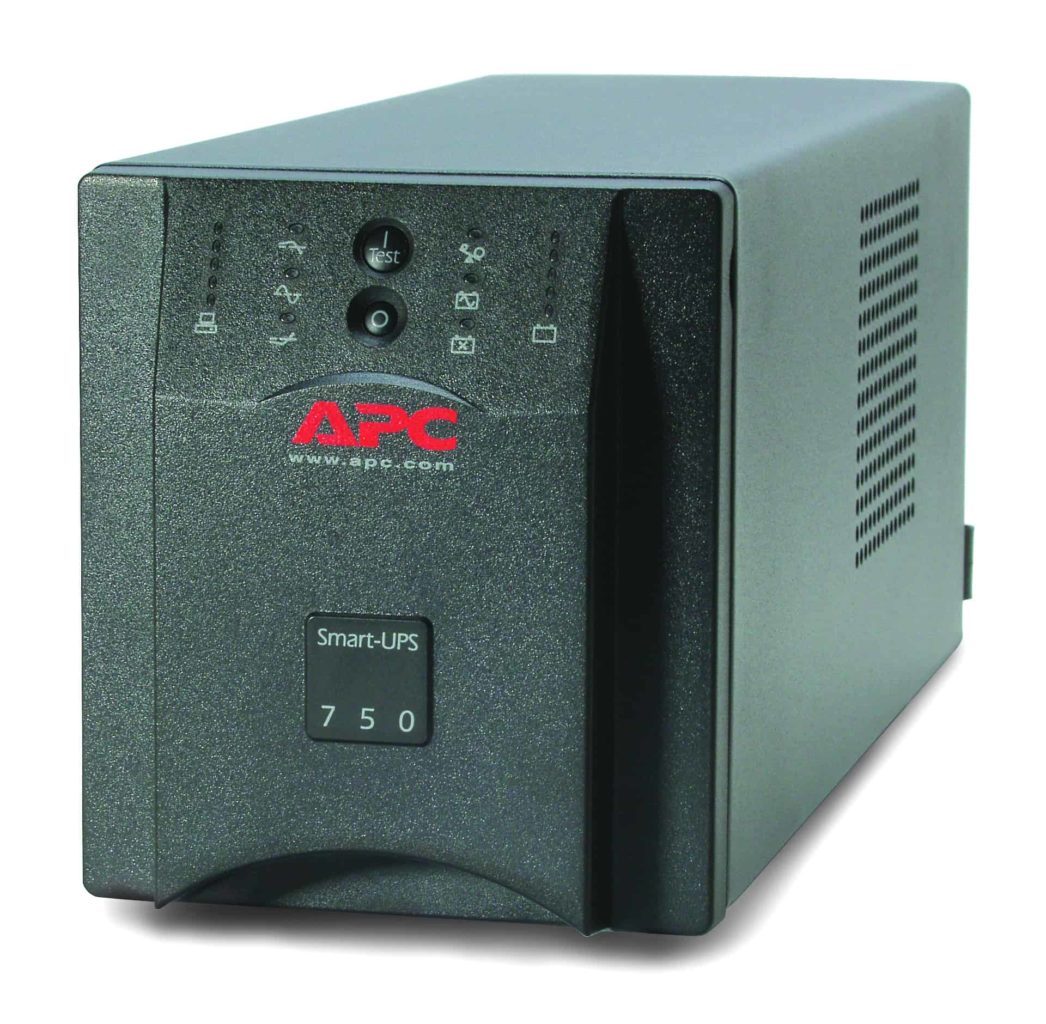

This one should suffice your requirements. It's an industrial-grade UPS and pure Sinewave output, switchover time is 2ms (A very important factor for NAS devices).

This looks good to me. You think I can plug my HT or may be components of it like Cambridge Audio CXR 200 or Oppo UDP 205; along with the NAS?
