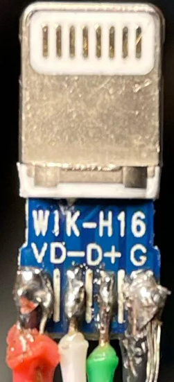

1. What exactly does the Lightning Camera Adapter do in my Setup 1? Is it acting as a DAC, or just passing the digital signal to my integrated amp? (Noting that iPhone volume control gets disabled when it’s connected.)

The lightning camera adaptor is a simple housing in which it allows the device to access a usb device and also two wires to charge the device. It is a simple electrical connection. The red and black are the power lines and green and white wire are the data lines. It doesn't have any magic inside and neither any dac. If you are philanthropic you can buy it from apple. If you are a poor guy like me, then make it yourself and make it look good by covering the ugly bits inside a heat shrink tube. You also have the option to get a lightning to USB on amazon that will be a fraction of the apple's connector. If you are affected by placebo, then the apple's original connector will sound better.
