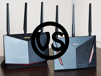

WiFi 6 is still evolving and down the line, the prices will come down but at this moment they are pretty costlier in India. I am biased toward ASUS based on my personal experience. You can opt for RT-AC68/86U, they are retailing around 12K in Amazon.

I am biased toward ASUS based on my personal experience. You can opt for RT-AC68/86U, they are ......
These Asus modems are getting lot of good reviews.
