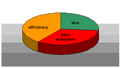

yes because the Dia is smaller it needs more power to move the same amount of air, from what i understand is a ratio of the area of the drivers.
size, efficiency and bass extension
Back to top
Efficiency is inversely proportional to the moving mass and - proportional to the square of the product of cone area and BL.
No matter what we do, we have to balance these three basic parameters, size, efficiency and low-end extension, the trade-offs in loudspeaker building.
If size is not a limiting factor, we can get really low bass and very high efficiency.
If size is restricted, we have to sacrifice efficiency - or low-end extension.
If you want high efficiency - and small volume - you have to sacrifice deep bass.
Etc.
The thing is - we can't have it all. You have to pick your priorities.
From Troelsgravesen
Hope this sheds light...a lot of it.
