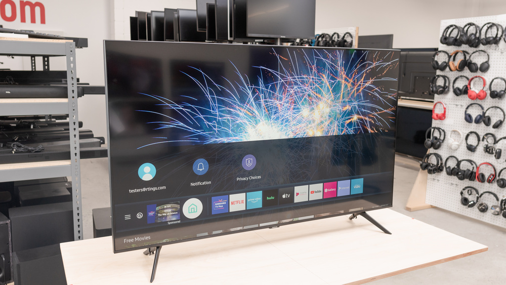

I did mention the prices of the TVs i mentioned, also don't blame me, on rtings website tu8000 is shown to support 4:4:4 4k 60Hz, same goes for q60t. I am also not recommending to anyone, i actually started the thread to get feedback of gaming qualities of 4k 43 inch amazon basics fire tv.
Also a friend of mine has 55tu7000 and the assasins creed valhalla pics of sun in hdr looked decent good, though i don't know if it has various shades of light around the sun like AC Odyssey so i can't really compare much.
And if you read my OP again you will see that i am looking for a cheaper gaming TV to get by till 2021 models hit stores or 2nd option that i am really looking for replies is LG CX/BX thing i mentioned in OP. Do have a look at it
