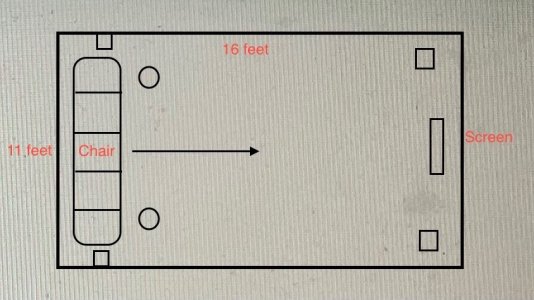

Hi, I am planning Upgrade my dream dedicated 7.1 Atamos Home theatre setup...
Room size 16*11 feet.
( Currently run with local setups)
Plan to Build step by step because of Tight budget.
Plan A- First buy Denon AVR X1800H, Front Left & Right Speaker and central speaker.
or Plan B- first buy Full Speaker Package- FL, FR, SORRUND, CENTRAL and sub Woofer.
Which is the Best One I choose?
Budget 1- 1.2 lks Max.
What is the matching Budget speaker with denon 1800h?
Basically Bass and Movie lover.
Users advice please.....

Based on your budget, if you purchase the complete speaker package, you may not have enough left for the AVR. Therefore, it's best to stick with plan A: buy the AVR and front LCRs. However, a subwoofer is crucial for watching movies, and fitting a good subwoofer, AVR, and LCR into your budget can be challenging. If you can slightly increase your budget, that would be ideal; otherwise, look into the Taga Harmony speaker set and the Polk HTS12 subwoofer for a good setup. Additionally, set aside some funds for speaker cables, interconnects, and connectors.
Are you planning to get a projector in the future, or are you already using one?

But taga harmony with denon sounds bright........you will enjoy movies but not music, obviously a subwoofer is must with both.....HTS 12 is good combination. Am using taga harmony 806f , surround Qacoustics 3020i with denon AVR-X1500H

Thank you for your valuable suggestion...we know Subwoofer crucial for watching movie..plan to buy step by step...thats y i asking ....
yaa Taga harmony is budget one but i 6ohm Speaker so denon avr has heat up with taga?,
how far difference between taga harmony 607 and Polk Audio Fusion 5.0 (55k) ?
I can increase my budget 1.5lks. please suggest best one.
are you satisfied with taga with qacoustic?
I haven't heard Polk Fusion, so I can't really say which is better. In my opinion, Taga should have better quality than Polk. However, as you mentioned, the Taga is 6 ohm and has a sensitivity of about 90 dB, which suggests they aren't very power-hungry. In contrast, Polk's 8-ohm speakers are easier to drive.
Q Acoustics are excellent speakers with a warm sound. When compared to Taga and Polk, they offer more detail and a superior sound experience. Ultimately, the choice is yours. Do you prefer a detailed, warm sound (Q Acoustics) that works well for home theatre and music, or do you want more bass and a fuller sound from the tower speakers (Polk/Taga)?
