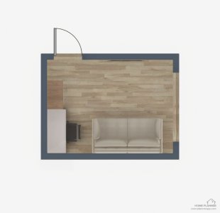

Hey everyone,
I’m planning to build my first proper home theatre setup and could really use your guidance.
Here are the key details:
Room size: around 12 square meters
Seating distance: 7 feet from the screen
Back wall clearance: about 2 feet
Primary use: Games, Music and 4K blu ray movies
Preferred setup: 5.1.2 (would love to include Atmos)
Budget: around ₹1.5 lakh, can stretch up to ₹2 lakh if it’s genuinely worth it

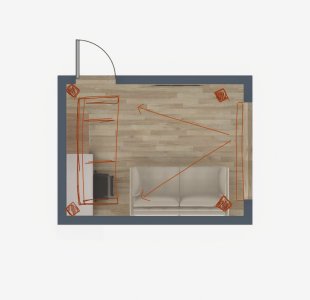

I believe I could do slightly better with the speakers because I'm going for basically 7 channels rather than 9 in a 12 sqft room.
Yes, you are going for 7 channels, but more or less it's the same. You have mentioned better speakers or a better AVR for future-proofing. I would say speakers in the Polk XT series are okay, but if you can choose the E series, it's better. But if you choose the XT series, then also choose the E series subwoofer. (If you can stretch your budget, then check other brands like Q Acoustics and Dali.) Other expenses include things like a media player, cables, a speaker stand (if you choose bookshelf speakers), other fittings, etc
This could be a better layout or vice versa, in my opinion, if it's a dedicated room
Thanks for speaker recommendations. That room placement would be absolutely ideal - only issue is that opening on the right wall is the balcony.. and this is a office + entertainment kind of setup..

In the room layout you showed in the first one, the sofa is close to the rear wall, and the rear speakers are close to your ears. At least a 1-foot gap is ideal for a surround experience (minimum 2 or 3 feet). That's why I opted for the horizontal layout maybe you can place your screen near to the door and in the balcony side, place a one-seater sofa with a passage on the center to access to your balcony That's another option; you can use an acoustic curtain on the balcony door if it is a total glass door.

Thanks for your insights on the room layout. What if I could bring the Sofa in a bit further from the wall? And get acoustic curtains like you said. The problem with the screen on the wall near the door is that the cupboard mentioned is grouted into the room, and it would be a lot of effort to get that out.

You should also consider the rear speakers; from your layout, you need to place your sofa very close to the screen to accommodate the rear speakers and the minimum clearance. i could suggest you get a bipolar speaker for your rear than a bookshelf

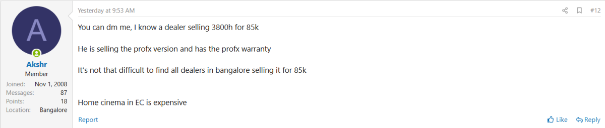

I have seen someone posted recently here that 3800 is available for 85K.
Good drawing by the way? iPad or galaxy s series ? :)
