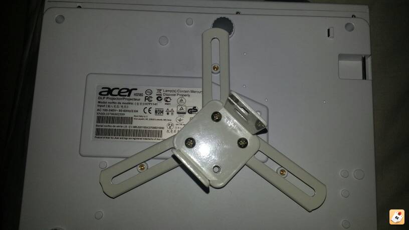

So finally after trying tweaking as suggested I am using the trainable three screw mount and will be getting it done tomorrow.
Final mount will be like this
Removed one wing. .

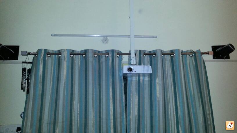

Got ceiling mount screws. And 3 mm long screws with washers.
DiY work starts tomorrow. .

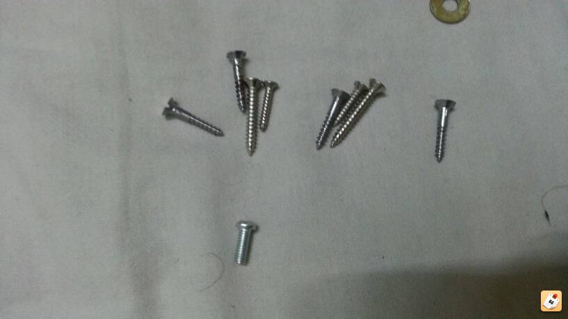

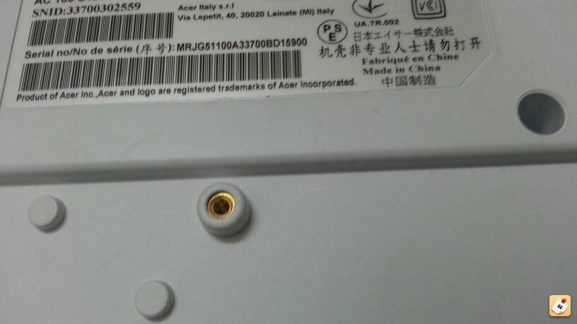

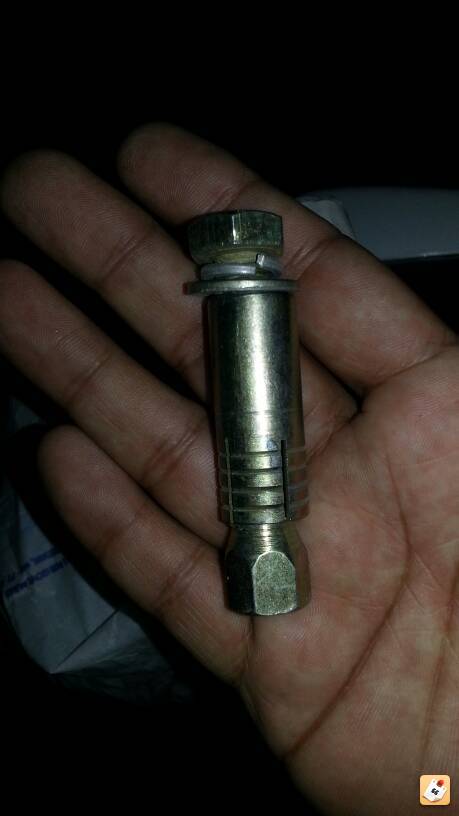

Guys nees help.. I have every kind lf screw possible. nutin seems to fit this damn hole.. I am stuck. Please help... as suggestes I got 3 mm screws every ones available still no go... please syggest what kind specifically I need to look for
The screws in your picture look to be all either wood or sheet metal screws. M3, means a machine screw, 3mm diameter. Most screws in US are 1 per thread count, so in this case, the screw is 3mm dia x 1 mm distance between threads x 20 mm long threads.
Hope this helps.
Hope this helps.
Thanks for the explanation. Yes those were wood and sheet metal screws.
Now I know what to hunt for...

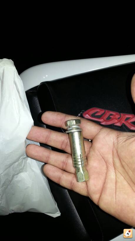

Went out checked 10-15 shops spent cpl of hours. Finally one shop har machine screws but he had no idea of those being 3 mm. I was unsure about them and as expected these too dont fit..
Fellow fm's would request you who have ceiling mounted the pj please if you have any spare left. Please post a pic..

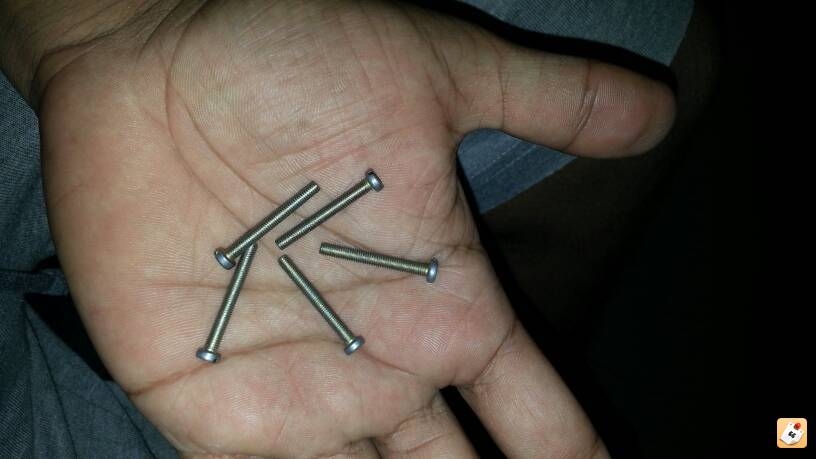

Try some screws from Auto Part shop,last time I needed one for surround,I did not get in Hardware shop,but Auto shop.
So finally it was already few days and I cudnt find the screws after spending hours and fuel. However as you suggested auto part shop came to rescue. ..
You literally saved my ass. Thanks a ton..

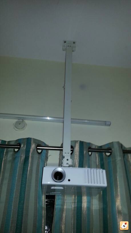

My ceiling mount is done today. At 9.2 feet from lens to wall the image size is 83 inches at full zoom.
40 inch height and 72 width
At 8 it will be close to 75 odd.

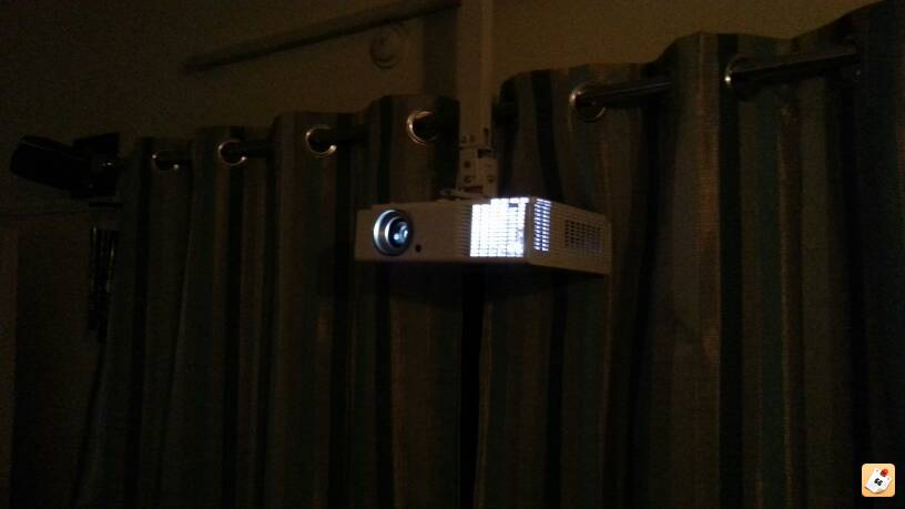

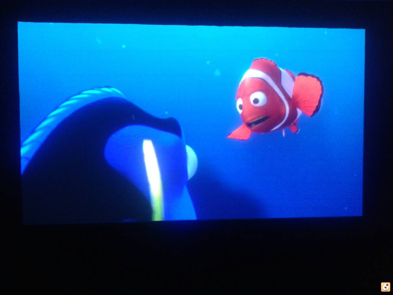

Congrats jidhin, so that is a VFM screen for the VFM projector... some more pics please, without any projection and in light.
Thats right prem,The screen costs me less than 500 Rs(Self painted on holiday:ohyeah:)I have used dulux emulsion which i bought some months back over the acrylic wall putty,The black border do a great job,But the screen is still reflective.I will go for a better screen after a couple of months.
