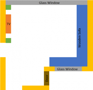

Below is how the room is set up.

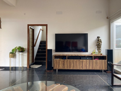

Wall where the TV is set up

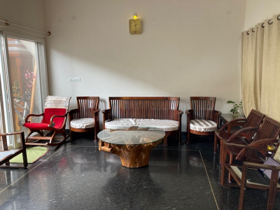

Opposite wall where the furniture is placed - this is the wall where the absorber would be added

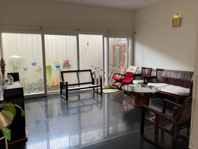

And finally, here's the huge glass window, where we are not adding curtains for aesthetic reasons

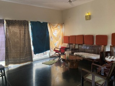

Spread a large bedsheet on the floor near the speakers and draw some makeshift curtains on the 2 glass sliders closest to the speakers, for the time being, and observe how this affects the sound.
to start with, without investing on anything, first do some experimentation on a free weekend. Bring the listening sofa away from the wall. if the center table's glass top is removable then do so or cover it with some bedsheet. keep the 1st or the 2nd glass window from the speaker side open. then start your listening session and along with experiment a bit with the speaker positioning, bringing it a bit into the room away from the back or side wall.
Now hear the difference, if you enjoy more then the minimum change that you need to do in the room is, bringing in a carpet on the floor and hanging in a curtain on the 1st or the 2nd window panel at least, or else put a sofa with more cushions on the glass window side. These are the minimum and obviously if you can measure then it will provide a better perspective.

I did try coupe of things over the weekend. And there was a lot of change, considerable improvement in the music.
I did not find a lot of difference with the the bedsheets I used. I will try again with thicker ones woolen blankets, quilts etc to see the real effect. I can certainly tell it will have impact.
I also tried with placing cushions from another sofa on the front wall, orange ones that are placed above the sofa in the image. This had a lot of impact on bass, all the boominess was gone and I could actually hear the quality bass that MusicHall is known for.

I did more and more experiments to a point I could not tell the difference :)
Covered the floor with carpet, the glass table with a quilt, cushions on sofas, curtains - it took a lot of effort to just see the A/B comparison. Yes it does make a difference, only thing is I could not tell which made the most difference, however, adding all kind of absorbing material vs none has a lot of difference.

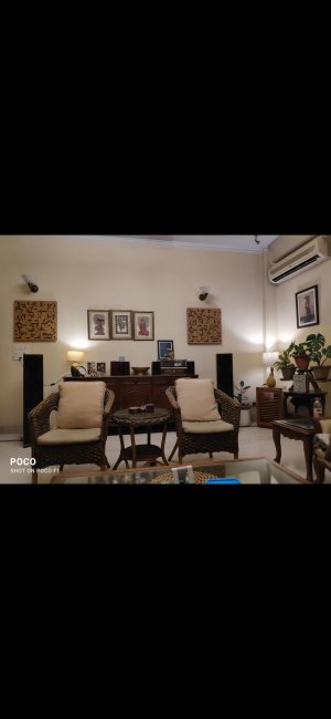

Pic below is a sample of my panels. 2 each on a single wall and rest a medium sized carpet in middle. As not a very large room. Later i put two small carpets in front of speakers too.
Check out the website 👇
Explained Perfectly:
I do believe if u put ur set up on the opposite wall where the sofa currently is and sofa where u hv set up currently. It will be very good for the set up as ur speakers will get equal/more space on either sides from the wall and keep them further apart from the cabinet to make space and then toe-in 10-30° firing at ur listening position. U can stand behind the speakers while u do that. Keep the speakers minimum 30cm away from wall or 1.5 - 2 feet. It will create a beautiful imaging effect.
Cabinet might be cancelling the inbetween field also. Mine is rounded on the edges. Hope it helps Try out 👍🏼 all the best.
The right speaker placed next the the glass is the biggest concern.
