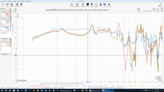

I am a dirac live user with bass control. I have umik already. Have null of 30dbfs in 71 to78hz area. But wantcto startvwith front speakers for now to treat using acoustic. Which model to buy

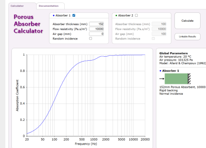

yes i have full bundle of dirac but can you tell if rockwool with 40kg/m3 density will be enough for low end absorption

I have no idea about the graph. But 152 cm is a lot. It absorbs bass a lot and bass will be prominent in the corners. So, you can use 152 cm panels as bass traps.
friend from germany suggested this for rear wall behind listening. massive null at 80hz
