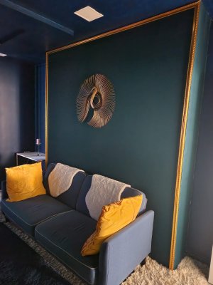

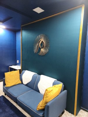

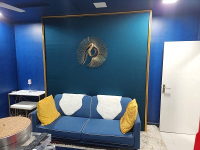

Just a continuation of my room treatment journey :)
After leaving my room with half finished bass traps last holidays, finally got round to covering and finishing them up ( 3 layers of covering to keep the geowool fibers locked in ). Still have to add diffusion on front wall and absorption at side wall first reflection points. Progress is slow as it is DIY, and iam a real lazy bum, with starting problems :D
Besides, I want the treatments to blend in with the intended victorian finish of the room, so still thinking on aesthetic ideas to accomplish the same, as I want it to look and feel like a warm, comfy and welcoming space to listen to music or do my reading or have a drink late evenings. Won't mind loosing out on extracting the most out of it sonically, as long as it stays a pleasant room to be in. Will post further updates as I add more treatments.
IMG-20221002-WA0014.jpgIMG-20221002-WA0012.jpgIMG-20221002-WA0010.jpgIMG-20221002-WA0013.jpg
View attachment 72381View attachment 72382View attachment 72383View attachment 72380
The room now looks so neat, clean and tidy. You also have done a wonderful job with the cables, I don't see any mess of wires.
Looking classic and Gorgeous 👏
Beautiful!
