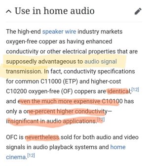

These cables are alright I have personally used them too. They say these are 99.9 OFC - which "if we trust them" is probably the best out there you will get as far as OFC is concerned. Beyond that is only complicated terms - imagined or otherwise.
In most cases - I doubt you will be able to tell, as always - I suggest take help of a friend, to do a blind test while changing cables - this is the simplest and most cost effective way to get rid of your biases. If you can tell a difference - well you have your answers.

I am getting theoretical but 99.9 OFC is 3N OFC.. there is also 6N (99.9999), 7N and 8N also available :)
@arj - true that and there would be many more where the 7N would be then restructured at molecular level to change the entire geometry & properties of copper itself - as per the claims.
But seriously - & logically - what are the applications in audio for that minuscule "improvement"? The last run of the cables within the speaker - how often will that be 8N copper? YES - but I stand corrected, you can get a lot better than 99.9% OFC apparently :p.
**I do not want to start a war - I genuinely am curious - what would the application of 8N copper in Audio be? How much improvement would that be from a 99.9 to 99.999999. considering we are 0.1% short of perfection in the first one - again theoretically?
the perception will be hardly noticeable (except to machines) - unless perhaps - every single piece of wire in the circuit and every copper part sticks to the 8N OFC - & even then those who can perceive are truly blessed.
Also again - purely for understanding - mathematically - if you can perceive 0.1% improvement in the quality of copper that there is a total of 1 or 2 mtr of in the entire chain that consists of multiple capacitors, inductors, various other metals, magnest - (I am not a mathematician) - are we talking about the hearing ability in super ultrasonic realm?
I can still understand that copper vs brass vs aluminium vs glass (this is best for bass BTW) will make a difference but 99.9 vs 99.99 :)
