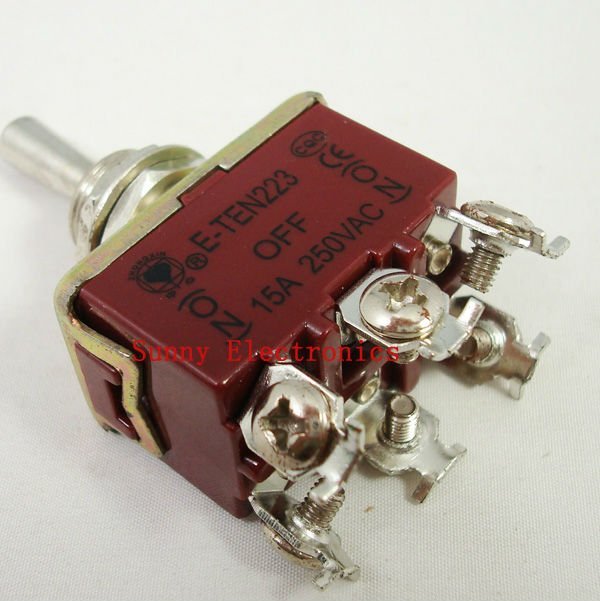

If you intend on seeking help of a technician, I would suggest a easy 'hack' of swapping the default power on/off switch with a 'DPDT' switch that will shut off both the phase and neutral supply at the same time.

I will first check out with a technician if a DPDT switch can be accomodated or not, if not then I will use a DPDT switch outside the amp, leaving the amp's switch on, and perhaps also provide a grounding. Peculiarity is that the Norge guys say slight current is induced to the body because of the high power torroidal tranformer, but their service center in kolkata says that is not normal.
Providing ground is easy and worth solution. It will add safety and quietness too, will take away some noise from PS.
I have already added a grounding, and as Sarith says I will add a DPDT outside the amp.
Other forum members who use Norge amps, should check out if they have this problem.
Thanks Sarith,
From images, it seems like the default power switch of Norge is a compact SPST or SPDT rocker switch. It doesn't seem like a DPDT rocker switch will fit. A switch outside the amp sounds good.
DPDT rocker, slide or toggle switch will do but an external power switch using toggle switch would be easier to assemble.
2pcs-Heavy-Duty-6-Pin-Momentary-Toggle-Switch-DPDT-ON-OFF-ON-Centre-Off-Free-shipping.jpg_640x640.jpg
Norge amps power switch is SPST.

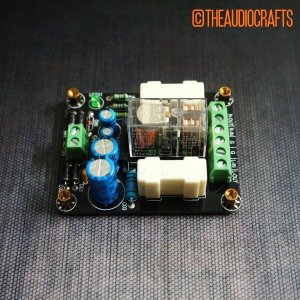

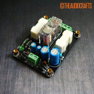

Since the power supply of the speaker protection circuit requires ac supply, how can you get supply to spc by connecting 15 0 15v dc side (ps to Pre amp) of norge amp? Kindly explain please. I want a SPC for my norge 4242 amp but facing problem for AC 12v supply. Am thinking to use attached SPC from The Audio Craft.
