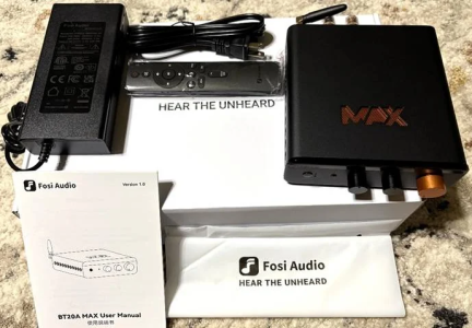

Packaging & Contents
- BT20A Max amplifier Unit, remote control, power supply and manual.
Build Quality, Look & Feel
- Case shows nice build quality with some color tone combination, looks really good.
- Remote feels plastic and works well.
- Bass & Treble knob / potentiometer are quite smooth running with center/middle stop which probably indicate 0 or neutral value.
- Motorized volume works nicely, responds to remote without any issues.
- Spacing between connectors is good enough for heavy cables & interconnects.
- The case is heavy enough not to be dragged by heavy cables.
Note: Tone Bypass bypasses Bass & Treble, however Volume Control remains variable.
