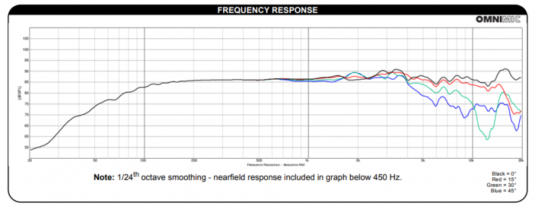

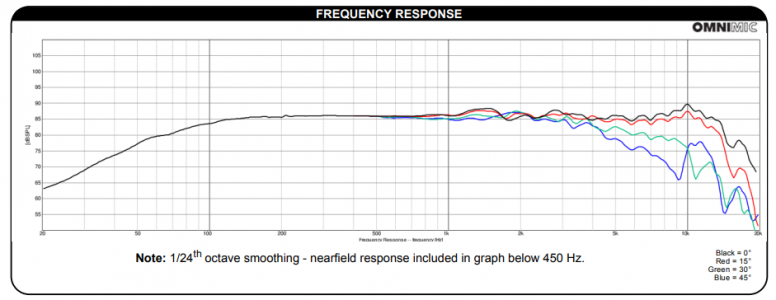

While I agree with many of the aspects you pointed out, I have a difference of opinion regarding some. For example, we are saying that Dayton RS 100-4 and RS100P-4 are similar drivers. But their polar frequency response measurements indicate slightly differently.
Here is the limited polar frequency response measurements of RS 100-4 (only upto 45 degrees)
Here is the same data for RS RS100P-4
I wouldn't compare low frequency responses as it is alignment dependent and there is fair amount of variation in their T/S parameters. However in the 400Hz-5kHz range, there are enough differences between the two drivers to make them sound different. One of the most noteworthy aspects is the uniformity of polar response for the RS100P-4 compared to the RS 100-4. One can see that the consistency of off axes response is maintained upto about 9kHz by the paper cone, whereas in the aluminum cone shown in the first plot, it sort of goes haywire after 2kHz. This behavior is certainly going to make one sound different from the other. The paper cone may be better suited in an application where one wants to have a low order high pass filter on the mid. It will also lend itself more to EQ in the higher frequency range since the driver anomalies present themselves similarly in ON and OFF axis measurements
Again, we are not looking at distortion measurements of these drivers, which will have differences and will contribute to some extent regarding their overall sound quality. Usually, the stiff cone drivers with high harmonic distortion in the break up region will lend better to passive notch filters for cone break up suppression than active notch filters. The passive notch will also bring down the sub-harmonic distortion rises caused by the the resonance-amplification of distortion products.
So, it is very hard to compare between these kind of drivers and predict whether they will sound similar given that we have differences in the frequency response itself.

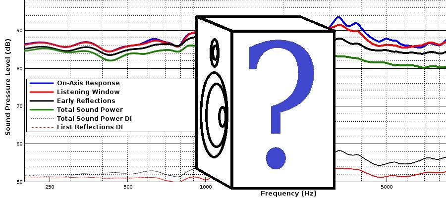

It is called Spin-O-Rama because it involves rotating the speaker 360-degrees on both its vertical and horizontal axes to gain the necessary data to develop the measurement set. A frequency response measurement is taken every 10-degrees on the complete vertical and horizontal axes, and the Spin-O-Rama curves are calculated from all of those measurements. The science used to establish this measurement set as a guide to loudspeaker performance has been held in such high esteem that the American National Standards Institute(aka. ANSI) and the Consumer Technology Association (aka. CTA) have incorporated it into their standard for measuring home audio loudspeakers. This standard is known as ANSI/CTA-2034-A.
I think many here with limited knowledge (this includes me, and I don't say this disparagingly) consider the frequency response measure as the lone arbiter of sonic signature. This is just one measure among many of a transducer.
And, yes, if all the measures are exactly the same, a mobile phone speaker that measures the same as a Scanspeak Revelator WILL sound (timbre included) exactly the same! :D
