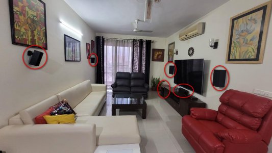

I need to ask if there is a possibility of adding Height Speakers to my existing 5.1 setup?
Please see the picture of my existing setup and suggest. I don't mind getting internal wiring done for height speakers.
BTW, my existing system is 7.1 and I have unused 2 speakers but I doubt if those speakers can be used.
PS: I know this layout is not good for 5.1.2 but I have been happy with this 5.1 setup since 2010 and now trying to accommodate Atmos in the limited space I have.

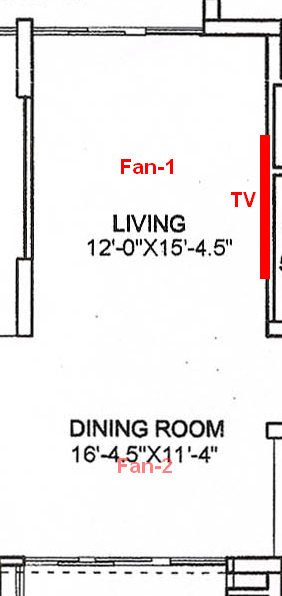

There are 2 ceiling fans in the room but the other one is quite far from the one seen in picture (It's a living / dining room, please see the attached picture).
Is it possible to install speakers in the concrete roof? Any links / pictures of such speaker placement please.
If it is easier/better to have height speakers on the wall, I can get internal wiring done. I am planning to get my home painted anyway in next couple of months. In such case, please suggest location and type of speakers.

Why don’t you try flat speakers like DLS in white colour. It will look elegant I feel.. bit expensive though.
I suppose you already have flat speakers on the front, from the pic. Which make is it?
