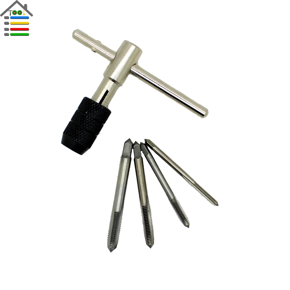

6. Tap Set of size 3 mm & 4 mm with Tap Holder https://ae01.alicdn.com/kf/HTB165j4MXXXXXaBXVXXq6xXFXXXn/5pcs-font-b-Set-b-font-T-Type-Machine-Hand-Screw-Thread-font-b-Taps-b.jpg
