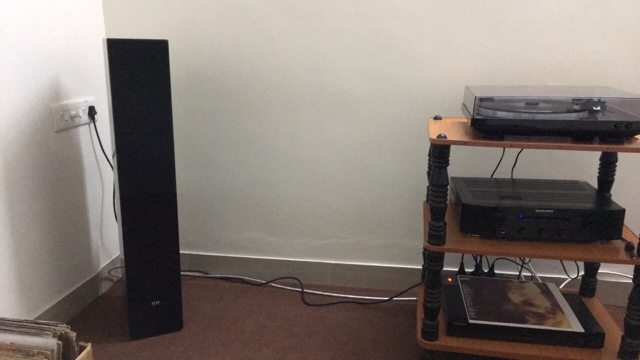

Love the clean 4 component setup you have there. Just curious, why does the speaker have a significant toe-in? Are they ESLs?

@Raghu: Thanks! The speakers appear like that because the picture was a cropped version of a wide angle shot! The Speakers are ELAC FS77 Floor-standers.

@Raghu: actually the speakers are ELAC FS 77 floor standers only! The picture I showed is a cropped version of a wide angle photo! That's why it loos like toed-in!
