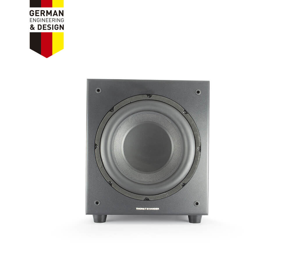

Hello everyone,
I currently own a Marantz PM5005 and BA26 setup, which has been delivering fantastic music-listening experiences. The BA26, in particular, has provided punchy and solid bass, especially in my previous small listening room measuring 14ft x 9ft. However, I recently moved to a larger residential space with a 255sqft listening area (15ft x 17ft) and a 50sqft passage. In this medium-sized room, I feel the setup lacks the desired oomph.
To address this, I'm looking to purchase a musical subwoofer that can fill in the lower frequencies and enhance the overall audio experience. I'm seeking a subwoofer with tight bass, and I plan to keep it for at least the next 5 years. My budget for this investment is in the range of 20 to 25K. After researching and considering reviews, I've narrowed down my options to a few potential SWs.
1: Thonet and Vander SW10 - Good Reviews, not sure about build quality
2: Taga - Good Reviews, Good Build.
3: BIC - 8" not sure if it will perform well in my medium-sized room, please advice. not sure about Build.
4: Yamaha - 8" not sure if it will perform well in my medium-sized room, please advice.
I could also see very competitive prices for these models on different online sites
1: Thonet
2: BIC
and
Though I have not heard about these online stores, can you guys let me know if any of you have bought any item from above to check the credibility?
Thanks in advance

Hi
Please go with minimum 10 inch driver, 8 inch will not sufficient for your room size,
Marantz PM 5005 does not have subwoofer out or preout,
So only option is high level output, so look subwoofer with high level input .( or you need to buy high level to low level adaptor)

All of.these models have high level of inputs, I am shortlisting these 2 below subs after reading reviews, and for that I am increasing my budget to 35k
1: Yamaha NS- SW 300 : it's available for 35k on Amazon with No Cost EMI.
2: BIC America Venturi V1020 or 1220 whichever is available and comes under 35k
Let me know what you think? Or any other options to look for,. Please note that I am from Mumbai.

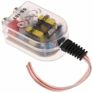

Hi Guys,
If the subwoofer does not have speaker-level input but only has the low-level input, how do I connect it to Marantz Pm5005? And if I can, is it still the ideal way to connect through RCA and will it get the same quality and control as connecting with speaker-level input? Let me know.
You can connect using high to low level converter. It will work same as high level inputs at back of active subwoofer which has them. It shall be different from connecting using RCA out from the amplifier but that can be corrected using frequency and gain controls of the subwoofer.
Can you throw some more lights on this? How these converter look, can it help to synce subwoofer with the amp volume control same as speakerlevel connection? I have dropped 212se option due to lack of high level inputs, and I don't want hassle of controlling volume on subwoofer for each song. Hence I am considering taga tsw 210 with high level.
With high to low level converter the volume of speakers and sub both will get controlled with the amplifier volume. You just need to set the frequency and gain in sub once as per you liking. One end of the converter is speaker wires which will go to the amplifier and the other end is RCA which will go to the active subwoofer or subwoofer amplifier in case you are using passive subwoofer. You shall be able to get this from a car accessories shop for around Rs. 200 if not you can DM me, I will send it to you via courier.
