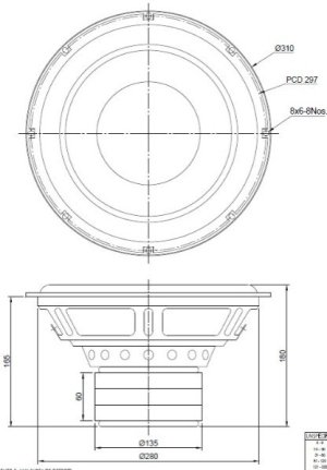

Attaching specs and dimensions for IWAI, as you cannot find these on official page yet, you can use WinISD and similar apps to compare.
If you need more help or anything you can DM me, Good Luck.

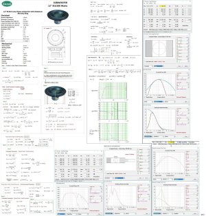

Above is the SB Bianco OB350 for open baffle subwoofer build. But the site is showing they are out of stock sadly.
There are well documented OB builds with this driver if your goodselves google and see. There is one by Javad Shadzi and the bithces brew project that Iam attching here.
will this not be more suitable for woofer rather then subwoofer because the frequency range starts from 40 hz
Yeah its a woofer designed for OB use. How low it goes, will depend on the baffle size. Though I think its Fs is around 34 hz, there are ways to build H-frames and Diploe subs to lower the Fs even lower. If you google " the bitches brew project ", two of these drivers with dsp go to 20hz too. So its possible. But yes, it is actually designed to be an OB woofer, and is not technically a subwoofer because of its higher Fs.
