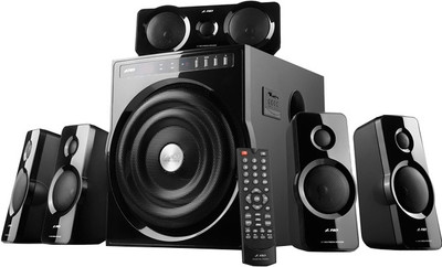

Dude if that is the case then why DOLBY pro logic only ? Why need the gadget at all ?? I am going to solve your issues once and for all. Your problem is solvable without any gear. F&D F6000/6000U has its own inbuilt prologic. U press that one button and sound will come from all speakers and will come very aggressively. I myself have owned both F&D F6000 and F6000U very recently. Stop before you do any more mistake.
The important thing to know now is how low you want to go when u say u dont care about quality. The most important thing here is that F6000 and F6000U do reproduce surround from stereo source in two radically different ways. here it is from my more than sufficient experience of both:
F6000 - It works on the principle of the oldest and very first type of Dolby prologic. Once you activate prologic,
Dialogue/Vocal is centered in center channel with little or more spread in front L R depending on source. Front L, R does not get duplicated in surround speakers and hence dialogue will very faintly or not at all come from rear speakers. The Stereo image instead (the collective impact of stereo field if u know what i mean) of Front L, R which contains selected sounds based on an algorithm gets extracted from Front L R and is sent to both rear L and R identically. In sum, one artificially created surround channel is duplicated between rear L and R. It generates a NOT 'in your face' surround image and is not as obvious as front L R, which is how ideally pro logic should be. You have to be in a center place of room to feel the final effect.
F6000U - It works on principle of duplication of stereo channels. Once activated,
Dialogue/Vocal gets centered in center channel but it will also come clearly from Front L, R, and rear L and R. This is because Front L and R are duplicated in rear L and R. And in this case, rear L and R are not identical. Exactly FL goes to RL and FR to RR. Now for many people this is more preferable as at any point in the room it is filled with with perfect stereo sound and dialogue is clearer bec its coming from all directions, and above all, creates 'in your face' loud stereo from rear channels. And so obviously u need not sit exactly in center to feel the effect.
3. As of now, I own a SD Airtel Digital TV Set top box. I havent upgradet to HD yet :p It sounds weird, but thats true! Well, it has analog output which I will be hooking to my LED and SPDIF (optical) output of the TV will be connected to this gear if purchased!
F&D will fabulously do this job as very few SD channels have got a really good quality stereo broadcast so any kind of prologic is sufficient for such sources. Even if you upgrade to HD soon, the better stereo will sound even better in 5.1.
I am not concerned much about quality but still would like to know whether the gadget is capable of producing true 5.1 surround sound or not!! Does it sounds cheap as the brand or is has decent quality?
The gadget and F&D will both produce true 5.1 from true 5.1 sources. However for the prologic function, F&D will also do a great job...just that it will not necessarily be the DOLBY pro logic. But again as the gadget is local make, use of word Dolby is as good as any.
The gadget produces pro logic in the same way as F6000 (not 6000U) with only difference being gadget will not send identical signal to rear L and R. it will be independent signals but trust me the difference is not at all identifiable unless you r really a high-end purist in audio.
Final Word, your purpose is solvable with or without the gadget with very minute variances between F6000 and the gadget and a considerably different variant in F6000U- U just have to take a call yourself. Peace.

So, F6000U would be my choice:licklips: You described exactly what I wanted! By the way, what you described was about Dialogues and what about music?? For the background music it will use the same principal or the music will be distributed to all channels evenly?
Don't mind if its not pro logic, its doing my job.
I will go with F6000U, but before I give my final verdict would you like to suggest me something else which is more affordable??? You are not aware what exactly I want, based on your experience let me know if any there is any other option available!
Great choice. The 6000U is actually much better also in terms of it being the latest one with USB options , and also it will memorize your last volume setting. 6000 was older model which did not have these features.
Music also it will use the same principle. To explain, when u listen to songs on headphone, u ll feel the instruments/orchestra appears spread out between L and R ear and appears in a wide soundstage. But the vocal/singer's voice does not appear to come distinctly from L or R - it somewhat feels to come from in front of our face. It is intentionally encoded that way. Prologic identifies that part of sound and takes it to center. Suppose u r listening to a non-vocal music which is only instrumental, still there will be some instruments encoded that way to make them prominent in front of your face. Those will go to center. The rest is same as described earlier.
For the given budget, no better option - F&D F6000U is the ultimate speaker system in its price range and there is seriously zero competition- this comes from very experienced and researched work. I will further go to tell u that the very next best option above budget is only the INR ~18-20K costing logitech Z906 model with optical/coaxial input but honestly, F&D is more than enough for your purpose.

Dude when it comes to aesthetics everyone has his own :D . My views are very seriously and solely based on performance. Look at the driver sizes they speak for itself- 2.5 inch speaker vs 3 inch, Subwoofer 5 inch vs 8 inch. Enof said.
The F&D F6000U looks like every bit the beast.
For PC speakers I've always used Creative, but since I graduated to HT systems I've started using old HTIBs from Onkyo for both of my PCs, pretty much blow everything away considering they are in the 20 to 33K range.
But if I had to go with PC speakers, the F&D F6000U makes it a very easy choice.
@htfan17 - Wondering if its only Dolby technologies upmixing or even DTS technologies like Neo. I know the war of DD vs. DTS is never ending, but I personally prefer DTS.
No Dolby. F&D does not use the word Dolby at all. Its just prologic. But like i said earlier, even if any company uses, dolby is probably too busy to sue them for copyright- take the gear in OP itself.
