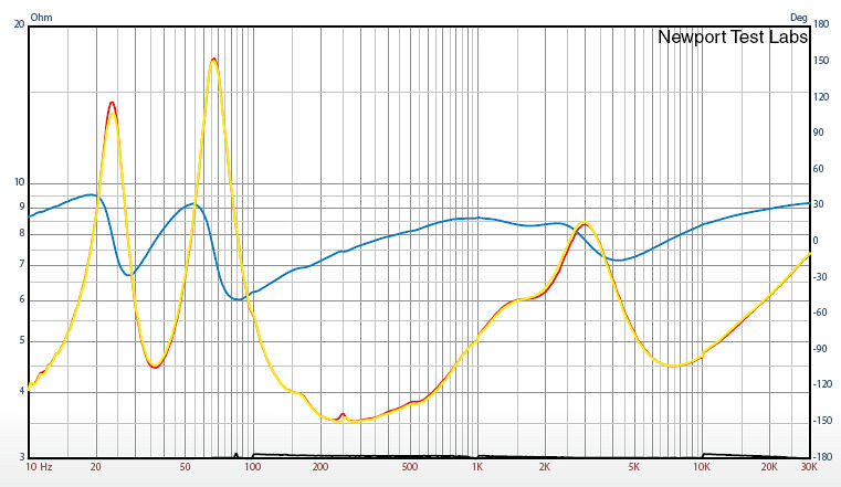

Which amp can drive which speaker with what ease is best judged by playing them together. Use theory to give yourself a starting point but never accept/reject a gear based purely on theory. In any case, here is the theory. Theoretically speaking; the Marantz you are talking about *should not* be able to drive the Epos. Look at the impedance curve of the speaker.
But practically? It might just do so. Some tips if you want to use this combination:
  1. Since you know your speakers are difficult to drive at certain frequencies, don't run them extremely loud (like party mode).
  2. Give your amp breathing space. Keep it ventilated. In Indian conditions amps also shutdown due to excessive heat.
  3. Since the speakers constantly remain clearly over 3.5 Ohms all the times, and over 4.5 Ohms over a large range, if the amp can withstand 4 Ohms nominal it will work well.
  4. Since the speakers are quite sensitive (92 dB), your amp will barely need to pump 1-4 watts of power to make it go fairly loud. So it should not ask too much of your amp.
  5. If the amp can't deal with the dips and spikes you will hear it.
