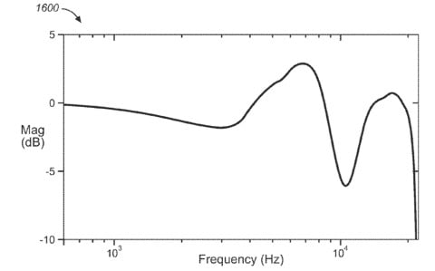

Atmos enabled speaker made by Onkyo are probably the least expensive up-firing modules you can buy. ALL Atmos enabled speakers contain a filter in the crossover that gives the impression of sound coming from above you (the notch in the diagram below) and suppresses the impression of sound at ear level (the two peaks in the graph below).
The Onkyo up-firing modules can be placed on top of your L/R speakers, and the combination of the filter above and the reflection off the ceiling will give you the height effect. I don't think it's as good as speakers mounted above you, but not everyone is willing to make holes in the ceiling, so for them this is a pretty good alternative (it works).
