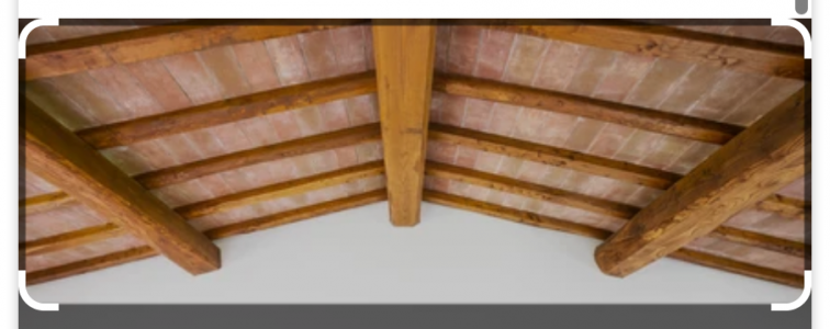

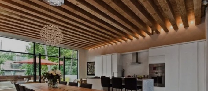

Wooden rafters , they look classy and will do 50-60% the job . After a while dedicated sound proofing solutions become an eye sore. Best thing to do would be to use wooden panels for entire room, and you can use insulation between panels and the dry wall. For cieling you could choose a panel pattern that is not linear and thereby reduces reflections.

Thanks for the suggestions. My knowledge on the materials is very limited. Any reference images would help me if possible to share.

Basically you can put traditional roof design elements in use , wood a natural insulator and rafters can work to contain reflections.
Hey
Thanks for making an effort to share the images. I love this design. Problem with my music room is too many beams in the ceiling that I need to hide or do the ceiling. But will see if I can do something with this kind of ceiling.
