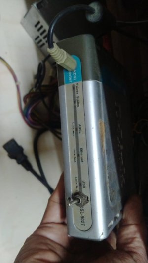

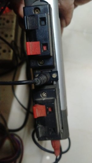

Ha e you made case for your amp? Can you guide me for the same? Or can you please give me some lead for case?
Sorry I haven't as yet. (shortlisting boards, etc...)
Making one out of acrylic might be a decent idea but it all depends on how much you want to spend and how good you want it to look.
Alternatively you could look at 3d printing something

For case , you can repurpose any old set top box or router box-visit a local scrap dealer. Plastic is easy to work with, compared to metal. Requires no special tools, just use hot nails , xacto knife etc to make holes.
