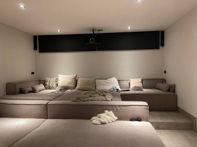

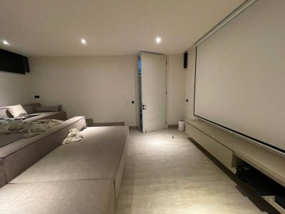

Hello all! Im almost newbie, who decide to make a great cinema room. I need advices for audio, avr, player.
I think i will start with 5.1, and maybe upgrade in future.
I have a dedicated room 600x470x300 cm.
Budget- wide, 5k$ max.
My current research give me
Q Acoustics 3050i Cinema Pack or Dali Oberon 5.1 Channel Home Theater System Oberon 7
Denon AVC-X3700H
We are sitting near back wall

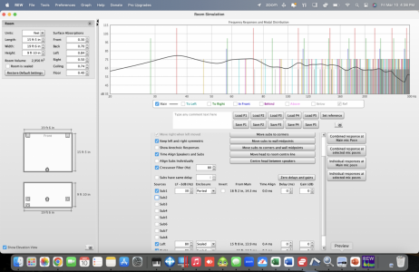

That is a great room. Just curious how come you have mounted your speakers so high and in the corners? I think you would get a lot better performance out of this room if you brought you speakers down towards your listening level and added some absorption panels in the ceiling and the back and side walls.
