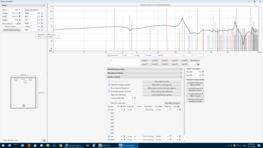

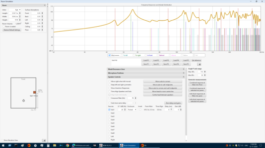

hey while trying room simulator if you see my current sub placement it is showing 6 inches from right wall is this possible as subwoofer itself is 23 inches in depth . can you explain this i am confused. we need to consider subwoofer cone which is in front for measurement or what?

Haha...yeah there are subwoofers designed to specifically go very very close to the walls to cancel SBIR. Lyngdorf audio calls them boundary woofers. And they are designed to be very narrow and placed touching the wall, so that the bass better couples with the room.
Since you have a normal sub in a box, you can try truning the driver towards the wall, and move it slowly closer to the wall and see. The REW picture you posted is showing the distance of the voice coil from the wall at 6 inches. So the driver will have to be placed maybe 4 inches from the wall, to get that 6 inch distance between the wall and the voice coil. I never tried it, but if you try it, please share how you find it. Thanks :)

The voice coil is at the center of the driver. But behind it, so cant see from outside. Best to use google images to see the construction of a driver.
If i dont face subwoofer front to my sitting position then i guess it is only 23 inches away from wall as depth of cabinet is 17 but if facing towards me then i guess it is only 17 inches from wall as width of sub is 17.no?

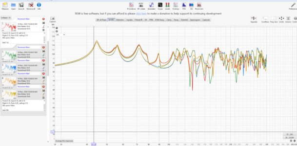

in room eq wizard can you tell i bumped up floor absorption to .97 and it made my graph linear. should i buy thick carpet for floor? with absorption it looks like peaks and nulls

Sadly No. The 0.97 that you entered is the co-effecient of absorption for the entire floor. What you have entered is that the floor is going to absorb 97% of the entrire sound hitting it. Thus, all floor bounce and reflections have been removed from the floor in getting that graph.
In sound absoprtion, 1 is considered the maximum possible absorption ( 100 % ). So .97 is 97%.

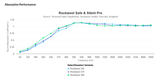

Below is a sound absorption graph showing the absorption co-efficients of Rockwool at different frequencies. And as you can see, it has an absorption of 1, only above 400hz. And again this absorption is based on the panel being placed perpendicular to the source of sound. And as the angle changes from 90 degress, the absoprtion will reduce and reflection will increase. So when buying acoustic material, it is worth while to check their absorption co-efficient graphs and see if the material is suitable for the frequency one is targetting. Second is to reduce that absoprtion co-efficeint by the sine of the incident angle of sound and see if at that angle, the panel is still effective or not. All the best :)

my sub having null in 70 to 89 hz zone what to do?

If you move that sub to a different place to remove that cancellation between 70 to 89hz, then you will have a new cancellation at a different frequency band. There will always be a cancellation, as long as there is a room. Only solution is to add a new subwoofer somewhere else in the room, so that it fills this cancellation between 70 to 89hz, at your listening position.
