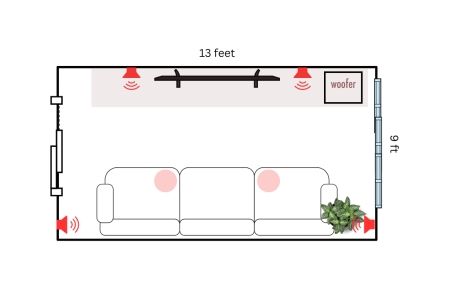

My TV room is about 13 feet by 9 feet with a 10 feet ceiling. I have also attached an image to understand the layout.
The longer walls have a window and a door so I have 9 feet for viewing and seating.
So the diagram and its content are not to scale, but I want to bring attention to the surround speakers. If I mount them on the back wall instead of the side wall, they might protrude past my head. Instead I plan to mount them on the side walls facing the sofa. Is this okay?
The Front LR speakers and the Center speaker will be mounted at ear level, Center speaker will come under the TV (As of posting this, it will be a 65 inch Bravia 3 2024 model)
The red semi transparent dots are height/Ceiling speakers. I have to move them overhead the sofa instead of the midpoint between the tv and the viewer because of the fan and cassette AC obstruction. This is not ideal but its what I got to work with.

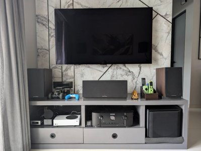

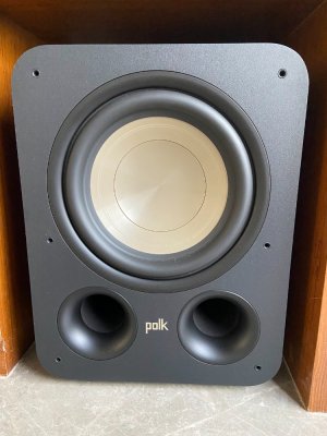

Subwoofer in a TV unit is not a problem, I am doing it image attached. However,
  • It needs to be front firing. Down firing will cause rattles in TV unit.
  • Needs to be sealed, the rear port will cause boominess inside a cubby.
So, in my opinion, get a sealed, front firing subwoofer and you should be fine.

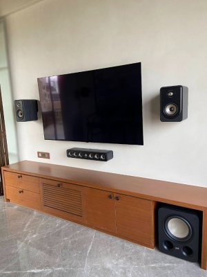

A mesh in front of the speakers is a bad idea. It will instruct the sound. Been there done that, and will suggest to avoid.
In your layout there is space in the corner to place the subwoofer in the open, and also not be visible. See if you can convince her. I didn't have any space and hence went with this approach.
For your room size a 10 inch is fine. I am using REL HT/1003 MKII in a similar layout and very happy.

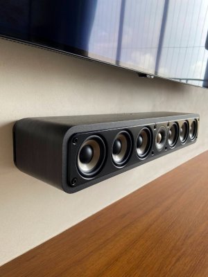

I was able to audition the POLK ES-20 as mains with the ES30 Center and ES10’s as surrounds with R60CI atmos speakers and the POLK HTS-10 as the subwoofer.
This has been my favourite setup so far. I am sold on the subwoofer already, It looks great and sounds even better.
I know most people insist on a 12 inch, but I have my reservations about it which I will discuss later.
The ES20s sounded great but were a little larger than what I’m looking for. So I asked the staff to replace the ES-20 with the ES10 which are sold as surround speakers but they still sounded really good. Almost so good that in a blind movie test I wouldn’t be able to tell the difference.So I think something in the middle like the ES-15 will serve me well.
The center speaker ES-30 is massive, comically massive. At the same time it loosk so good, aesthetically it's my style, but realistically I can’t have something that large in the smallish room, so we did some A/B testing with the ES30 and ES35 which is a smaller center, surprisingly both the wife and I liked the sound of the ES35 more and the size is more befitting too. I am now considering ES-15 + ES-35 as my LCR with the ES-10 and HTS-10.
