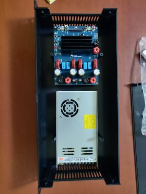

This is how i am planning on the placement. I would have loved to have more space in the box, but need to make do with what i have. The thought is to keep the mains power line as far away from the input. The fan and the amp out are too close to my liking; but i feel it should not cause any issues. Any thoughts ?
I have placed them side by side. The amp is silent when not playing. As the input side is far from the SMPS, it should be fine

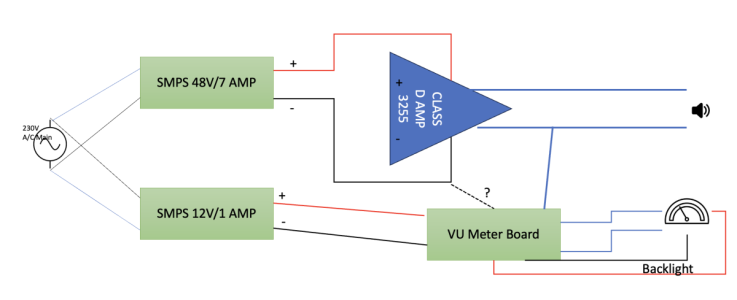

I had a query on connecting VU Meter driver to a class D amplifier.
if we connect the SMPS ground of main power amplifier to the SMPS ground of the VU Meter board, considering both are powered from the same mains, will it cause issues ? As i understand, SMPS do have HF transformers inside, but do they provide isolation ? The dotted line in the diagram is the area of concern. Would it be right to connect the 2 SMPS grounds ?

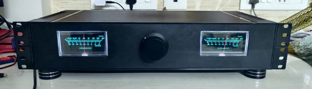

Finally, i completed the build. I know..it took 3 years :) . I have coupled this one with a valve pre-amplifier. The sound is good. I am happy with it. been listening to it for the past few days on my test speakers. There is a pop sound that the amp makes on power off. Hence a bit reluctant to connect it to the main speakers. This is how the completed build looks like
