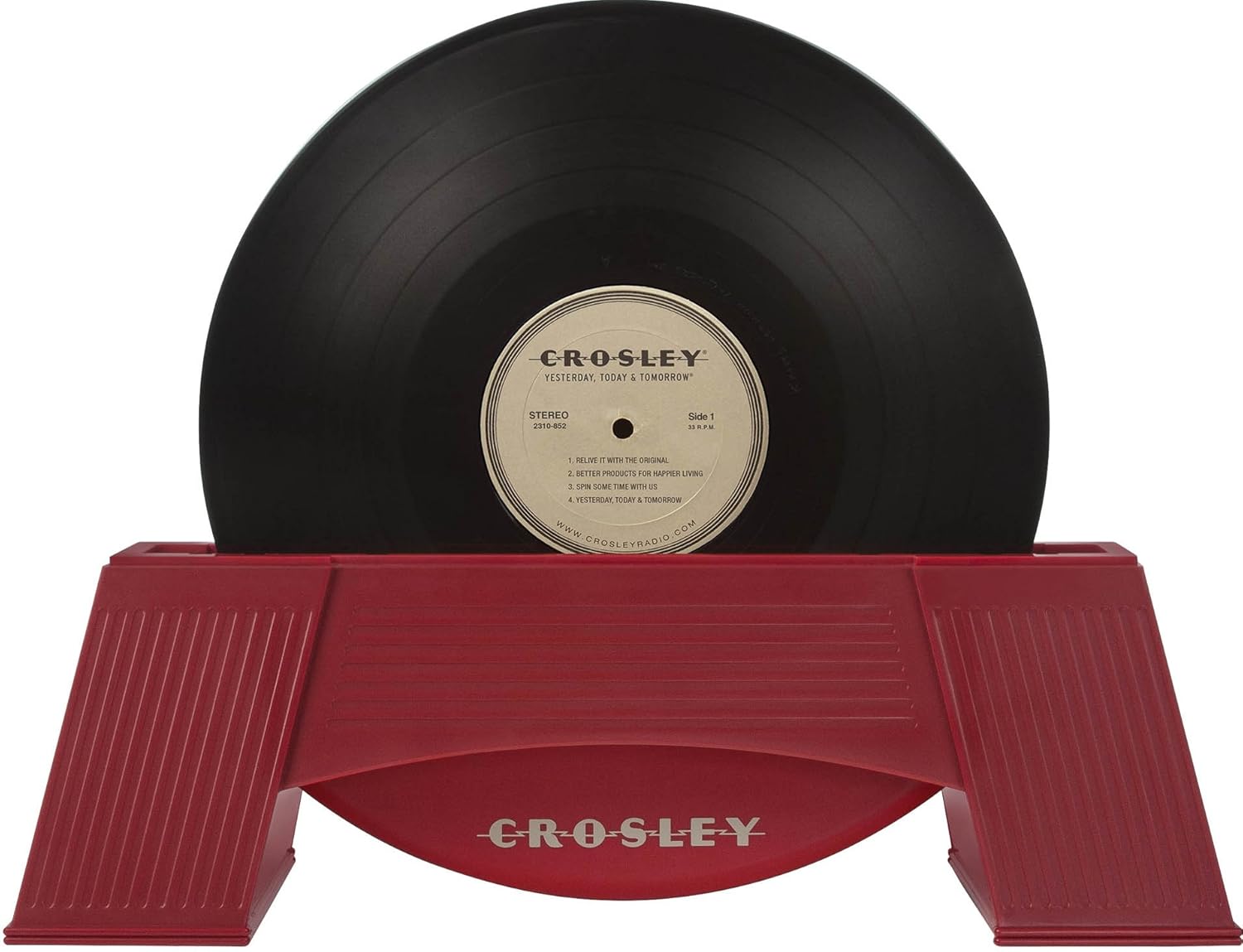

I bought spin-clean record washer system few months back and cleaned few records, amazing result :) It doesn't just remove dust and dirt, it also removes bit of static. I am quite happy with the result, now record labels doesn't get wet.
Got this for $49 on special summer sale.

I also have spin clean record cleaner. The consumables are expensive compared to other systems. The quality of cleaning is good . I use it when people buy records from me in bulk and it is faster than my vacuum cleaning system
Have you ever ended up with wet labels using this system?

i had tried the nitty gritty brush + baniyan cloth cleaning method, and found it not so satisfactory.
bought a knosti disco anti stat, and with homebrew liquid, works just fine!
It comes with a drying rack that the spin clean doesnt have!
