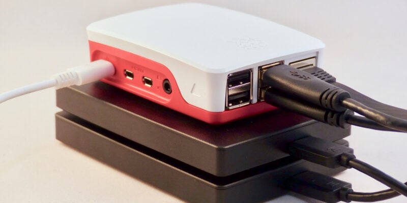

I would suggest getting a RPI4 and installing OpenMediaVault (OMV) on it for a NAS setup where you can connect 2 external HDDs. If you want I can post links to video guides on Youtube showing installation of OpenMediaVault on RPI.
I have 3 NAS setups and one of them is based on a RPI + OMV:
As you can see from my above setup that I have a powered Tp-Link USB 3.0 hub to which I connect my external drives and then connect that powered Tp-Link hub to the RPI. However, I have connected 2 non-powered external HDD's to the USB 3.0 ports of the RPI 4 and the RPI4 was able to handle them fine, without issues. I'm using the official RPI4 power supply adapter and cable to power the RPI4.
