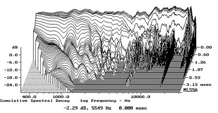

no man you got it misunderstood im not talking about breakup im talking about ridges in the waterfall plot. Aluminium is light and rigid for the decent pistonic behaviour but the energy residue in aluminium is high than silk domes thats the problem. Thats why silk domes are preferred and dont have any color associated with it.
Simple just tap a little with a match stick to the aluminium dome and try to hit it to the silk dome you will understand why.
you can see the ridges at 4k to 6k..
http://www.stereophile.com/images/archivesart/N33fig8.jpg

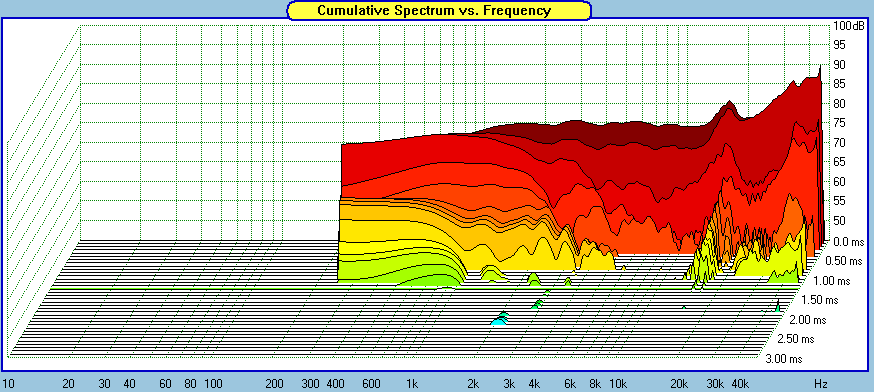

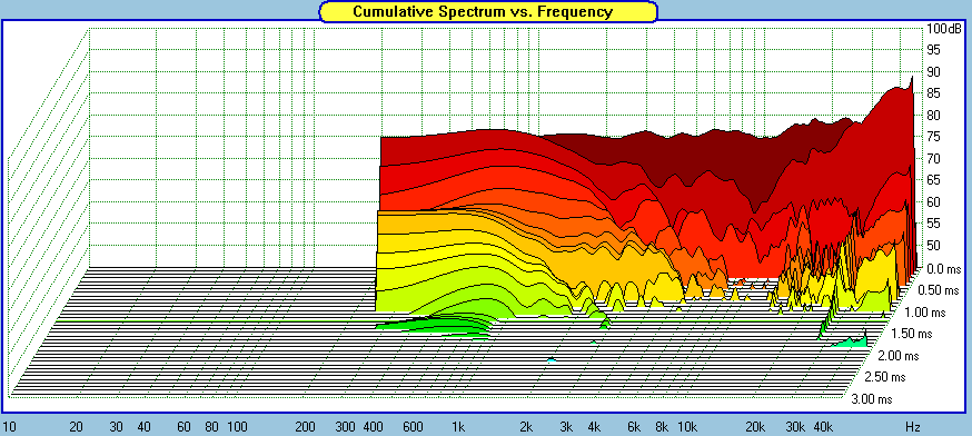

finally, just for fun, I am linking 2 CSD plots. identical motors, difference only in Dome material. 1 silk, 1 metal
Can you tell which is which, and which is better and why?

The top one is definitely a silk dome and better the bottom one is somewhat better than aluminium dome if im not wrong it must be titanium dome.
The top is better because look at the ridges between 2k and 3k between 1ms to 2.5ms (Most sensitive region for human ear)
so what does that signify is the mechanical energy which is being imparted to the dome will be converted in to sound energy but a partial energy is stored for short duration of time in metals and they release it after few milli seconds. Now here you see only single sweep but what happens on a complex multi tone musical signal the ridges form everywhere scattered thats why metallic domes dont sound good.

I'd say that you should know that to read a CSD plot you need to look at the fundamental first and then the decay. also you need to look at the CSD from a passband perspective. i would say 2 things.
1. there is very little difference between them.
2. in the upper frequency range the 1st is actually ringing more. (remember to look at the fundamental). as it is in 3-4k range. and the 6khz+ range.
