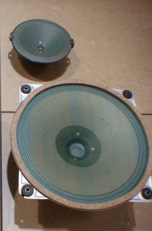

After having heard so much about the Saba green-cones I am getting a SABA 4" and 8" tweeter woofer pair

Available only on ebay and you need to evaluate its condition

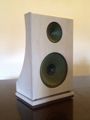

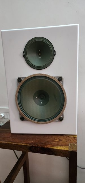

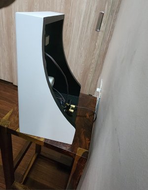

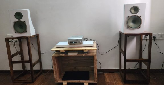

FInally got the speakers done,. Put in my Office room and running with a simple Denon Amp. My Aries mini is connected to the same so this is primarily the streaming setup and my main setup is only CD+Vinyl ie serious stuff .
@sadik has done an exemplary work again in building this and shipping it in a Wooden Carton ( !!) which i am using as the make do rack in the pick..yup its a cheapskate setup an trying to use what I already have.
So drivers around 21K landed, woodwork/finishing/shipping cost around 20K so all done for 40K.
Now the Sound
Being OB and limited bottom end, the sound falls sharply from 80Hz but above that its so transparent and with wonderful imaging. Have put in an old sealed box Sub i had and it fills out well but still need to get it integrated and thats going to take long.
Do need to test this fully but very happy with what its doing for now with some jazz and vocals,.
