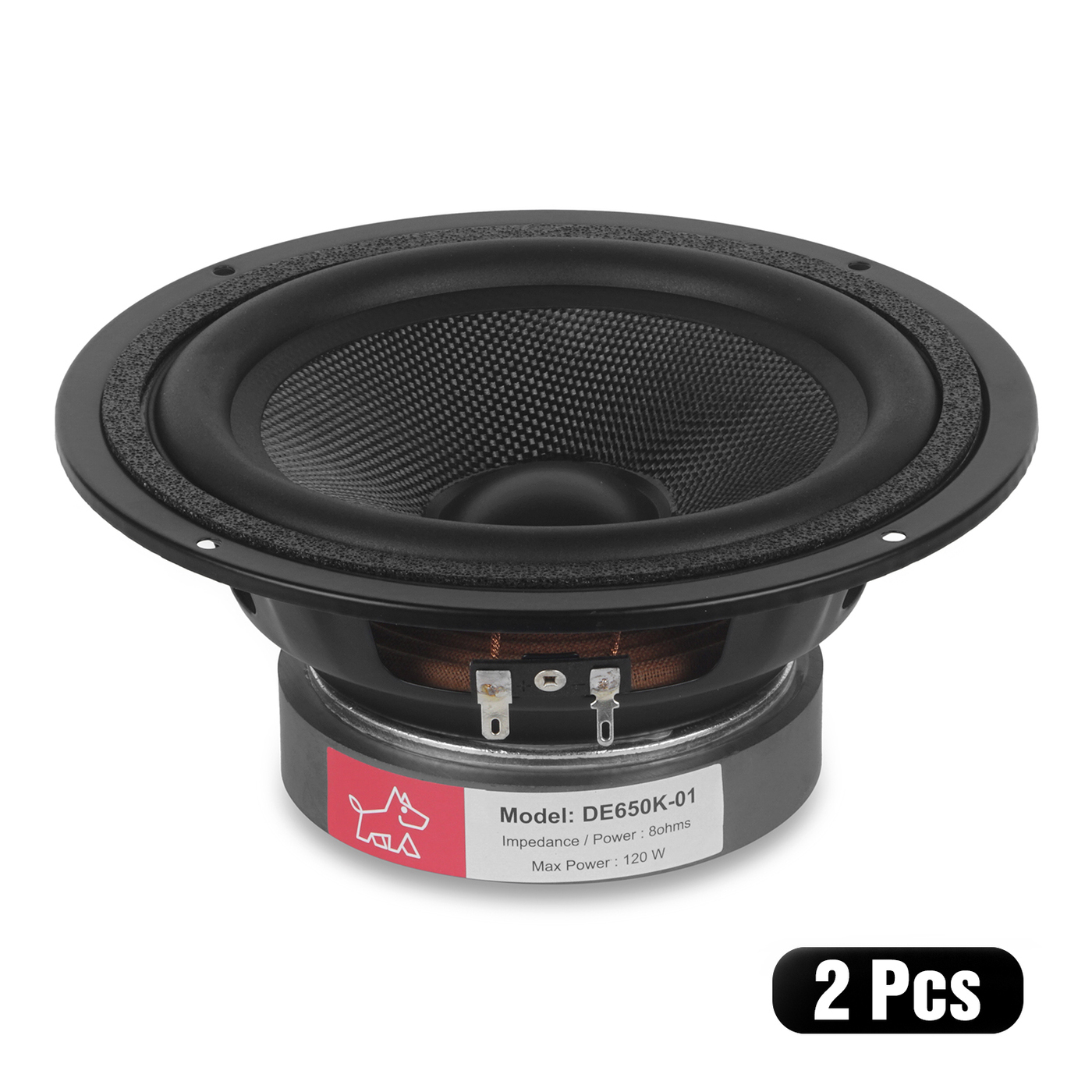

Plan:
I'm planning to create a TMM tower speaker with a height of around 35-42 inches and a width of 7-8 inches, inspired by Paul Carmody's Classix 2.5 design. It will feature a 2.5-way configuration, where one woofer will be equipped with an inductor to focus on slightly lower frequencies compared to the other woofer.
Goal:
My aim is to construct this speaker on a budget using drivers that are widely available in India. I initially considered using drivers from Doogesound, although their limited edition drivers are currently out of stock. I haven’t had the chance to try Sweton speakers yet, so I’m a bit unsure about them. I’d really appreciate hearing from anyone who has experience with them!
Suggestions Needed:
I would appreciate suggestions for selecting drivers and determining the appropriate cabinet size. Any guidance or plans you can provide would be extremely helpful. I am open to modifying my approach based on your recommendations.
Previous Experience:
I have built two speakers so far: one featuring a full-range driver from Markaudio and another that is a two-way design using a Chinese driver. I am still learning and seeking to improve my understanding of speaker curves and cabinet design.
