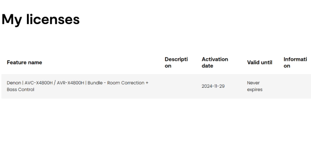

i bought full bundle few days ago. i bought pb 2000 pro but room was small so was having null issues. without dirac you need to do subwoofer crawl and all that . but with dirac you can put your subwoofer anywhere and it will do the job well. consider it like AI(ARTIFICIAL INTELLIGENCE). now in my room bass feels not coming from neither speakers nor subwoofer it feels coming from walls and you cant say where bass is coming from. If you feel where bass is coming from then not good. you are having localization issues
