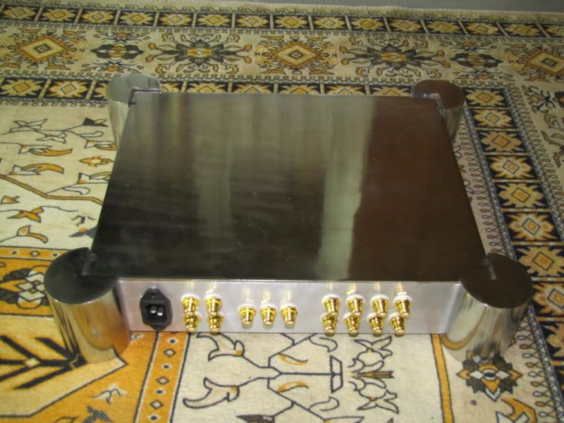

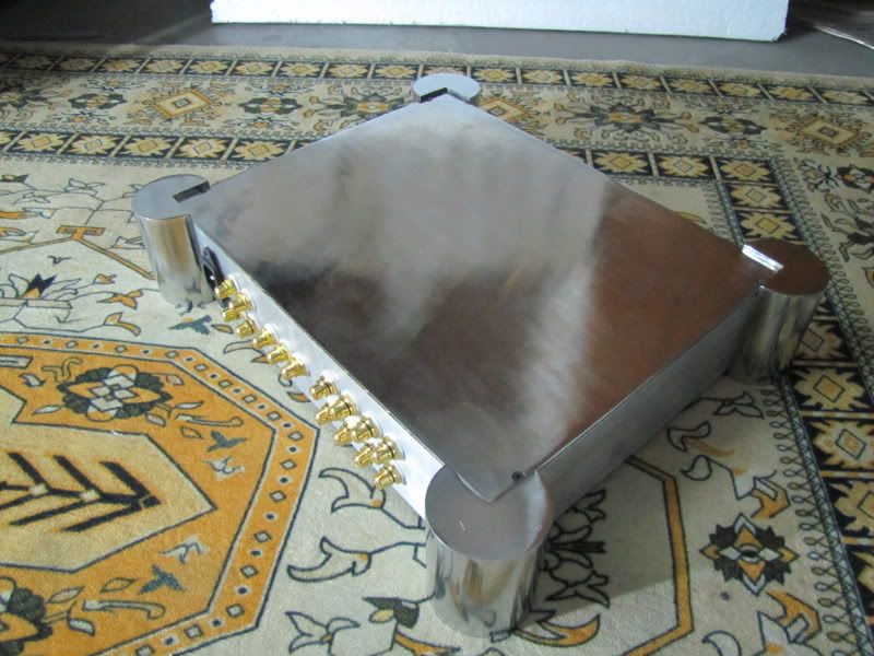

Looks great, love the cylinders in corners which I am seeing for the first time in DIY.

The cabinets look classy. :clapping:
There is a lot of DIY electronics in your photos. Can you elaborate a bit more? How does the entire setup sound?

Hi Sumit,
Neat work, not just the cabinet, the circuit boards also. Very refreshing to see a breadboard approach...All the best...am sure it will turn out excellent,
Goldy
Thanks Goldy..... the two circuits with heat sinks on them are 5v and +-14v regulated low noise power supplies for the DAC and I/V circuit. The relay boards are for analog and digital source selection. As the box will have the bi amp filters installed inside i need to switch the analog sources that i have through this box. And second set of relays are for digital source selection cd/DVD/bule ray. Will update detailed circuits when i reach final versions.
As u know sound is a very subjective issue ...but it sounds less restrained ..... highs are better i think.... than the Marantz CD-63II K.I. Signature which i have and compare with.

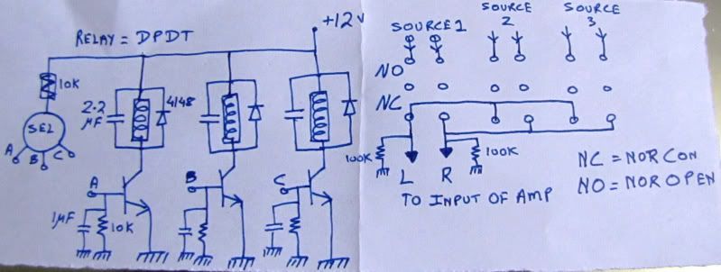

@sumitdutta77,
the enclosure looks classy, and the corner cylinder approach is the first i have seen, especially in diy projects,
and can you please elaborate a bit about the "relay circuit",and what type of switching you are incorporating for driving relays,
i am in the same scenario where i have to switch between the inputs so researching over it:)

thanks...
The relay board is very simple. Though now its controlled manually using a rotary switch...latter i plan to use an universal controller module ( control my whole music Rig through it....volume/source select/eq/projector/curtains/room lighting/ etc etc etc) .
As for the current schematic please check the image:-
http://i130.photobucket.com/albums/p266/sumitdutta77/IMG_0912.jpg

Awesome... do use the Aluminum polishing thread in HTPC section for jawdropping finishing touch, i wanted to know how such nice square cut on aluminum is possible..
all the best soon i will attempt a big daddy like this ... i have got v good SPDIF feed [secret]
Do embedd the pics using the image icon
Impressive work with the veroboards. I never thought someone could follow this approach for a complex project like this! Kudos to your effort.
