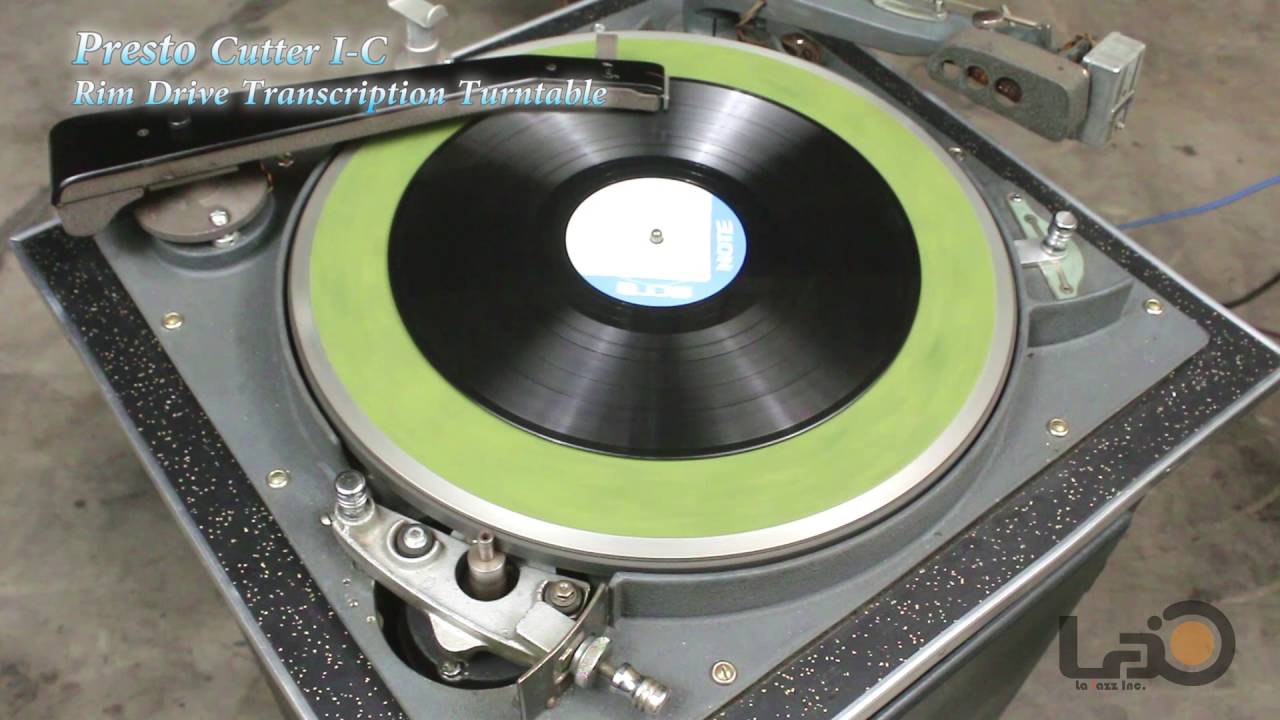

Following this thread with great interest. A belt is the easiest to design as motor vibrations can be best isolated via this and hence you may have more options around the motor. Can i also suggest looking at a Rim drive ? speed control of the AC motor will need to be managed via selection of the right diameter of the Idler wheel.

I have no clue what a Rim drive is. Will search for the same. Drill motor will be too vibrating and noisy in my understanding.
am sure a small rubber wheel instead of metal on metal could work ...
