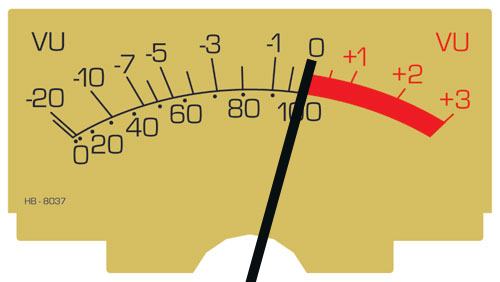

Some info on the VU buffer adjustment :
1kHz sine wave at +4 dBu (1.228 Volts) On the the vu scale needle should read zero
===DONT get scared as a keep it simple principle play some bassy tracks , adjust gain pot to cover the max that all
we are not doing studio recording so that will do fine
FUN FACT #1: Notice the secondary scale below the -20 to +3 scale. This is a carry over from the old days when Radio Broadcasters used the meter. It represents Percent of Modulation. In order to have the loudest signal available to radio listeners, Broadcasters would try to keep their audio level near 100% modulation mark without going into the red and over-modulating the signal they were broadcasting.
[just dont care markings !! ]

I also love them true vintage scale and i like the glow after my diy fit ,will wait for your pics of complete build .
how you are driving?it is best to drive from AV lines unsing the buffer but speaker outs also can be used
with this very simple circuit http://www.giangrandi.ch/electronics/vu-meter/vu-meter.shtml(use 10k at last to protect them , they are 50uA)
And i always like to bring DIY items and see people get happy.
Care ful they need very little current 50uA
