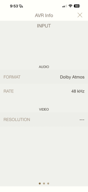

I noticed few days back when it passed through Dolby atmos for a movie on Amazon prime, will have to check exactly which movie was this.
I rechecked 2-3 times to be 100 percent sure it was playing dolby atmos.
At the same time, it didn't do atmos for Netflix.

Checked with other Atmos movies on prime, can confirm Atmos works just fine with prime video. One may check Shershaah movie.
