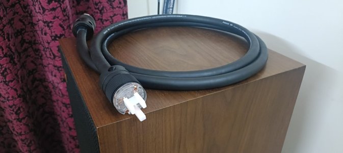

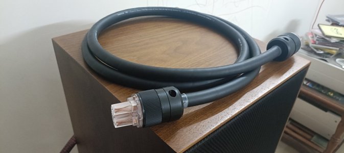

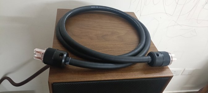

Dual shielded 3 core 4mm sq power cable
Yes these are pure copper US & IEC connectors. I imported these from Singapore.
just noted that you are using US Type B plugs. Are you using this in India with 240V supply? They may fail for a surge since these are rated for 120V use. If they are not tested and marked for NEMA / IEC wouldn't use them.
And these do not seem to be standard US plug. Type B has a round earth as per NEMA not a U shaped one. some of the surface area for earth terminal is lost.

The ground pin is U shaped one only.

The ground pin is not as per NEMA 5-15. It has to be round not U. Hence, I doubt if the plug is certified.

Made three more power cables of 2 meter length on the remaining length with bare copper terminals.

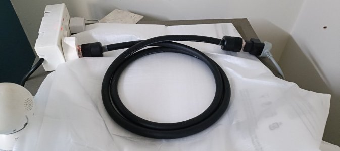

To complete burn in time fast. Connected the cable to my Bosch refrigerator which always in power on, actually one of my friend suggested this to to mellow down the new power cables.
Got few Universal and ICE converters to do the same.
I have completed more thank 8 days so far.. think it's time to test it today evening.
