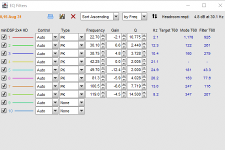

You're generating the EQ filters through REW, then? If so, check the auto-generated filters for the Q values.

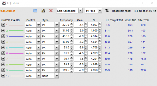

Yes with REW. I have attached the image of the auto eq filters. I normally don't check these values and just load the eq
At least 3 of the filters have Q values greater than 7. Run MSO by limiting Q to <=7 (ignore the FR which is likely to be worse than what you got with REW) and listen to see if things get audibly better in the time domain. You can then decide if the trade off vs a better FR is worth it.
OK i will try MSO with what you have suggested later. Totally forgot how to set it up so will have to check the tutorial again. In the meantime ill try the same approach in REW with the existing measurements. What you are suggesting is the Q values should be less then 7. So i tried to achieve the same in rew eq modifying the the filter tasks. I disabled "allow narrow filters below 200hz" and now the q values are below 5 for all the filters.

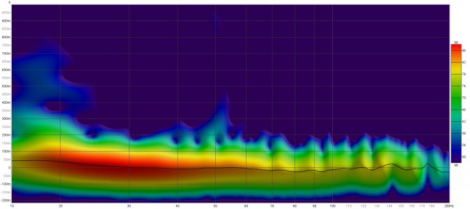

Cool. Is there an audible difference to the sound and is it for the better?

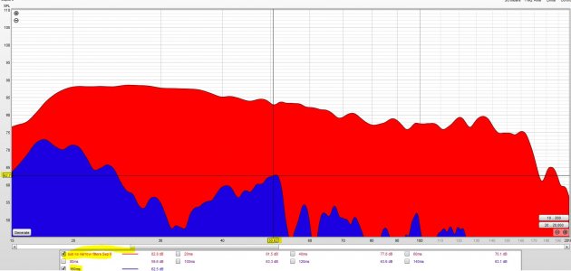

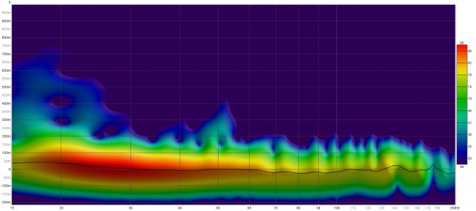

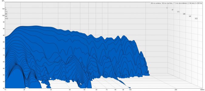

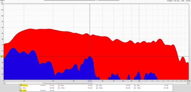

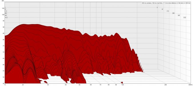

I listened to few music tracks and watched few action sequences. Measurements are almost the same with very minor variations. But there was some decent improvements in how bass sounded. Some boomy and localised bass notes are gone.Very minimal improvements with decay time as well.Thanks for the suggestion
Can you post the before and after waterfall/spectograms?
Sure but not much difference. In decay graphs there is improvements . Audible difference is i do not hear some of the bass notes strong and loud.
