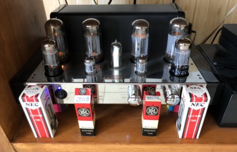

My Elekit TU-8200 is an auto-bias amp that can take up to KT90 in KT series, EL34, 6CA7, 6550. It came with 6L6GC.
I have matched pairs of KT88, 6CA7, 6L6GC from EH and Tungsol EL34B. KT88 is full sounding while EL34 had a good midrange. 6CA7 is overall better as per my ears - unfortunately during a tube roll the alignment pin broke in one of them.
Can't agree more.
