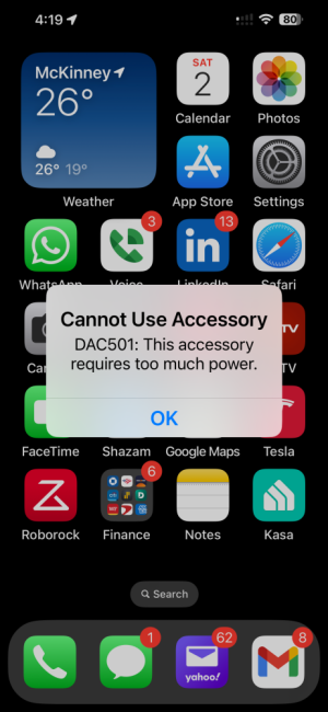

Do you see this kind of warning when you connect your iPhone to DAC? If yes, you will need camera adapter kit so that you can hookup both charger and the DAC simultaneously.

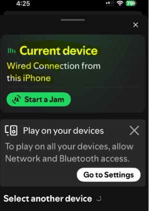

When my DAC connects to iPhone successfully, here is how it looks in Spotify.
First not seen. As after connecting dac to Iphone
Headphone sumbol appears and when ckicked shown eversolo with headphones. Today I will connect again and take pic.
A message popup like connected to Accessories. Then again message connected to Headphone or other device.
I have clicked on other device.
Increased tge volume on dac and avr.
