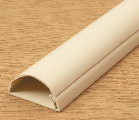

You need 4 items
1) conceal pipe channel
2) 3 pin socket with switch fitted in a box (the white box)
images
3) 3 ping plug
4) Exact length of cable required
Connect one end of cable with 3 pin plug and other end in the box with 3pin socket and switch. Fix the box mentioned in 2 close to your sub. Connect 3 pin plug into your existing home power socket. Ensure cable is running across the wall but inside the conceal pipe channel. It will not cost you much, if you do it by yourself or get a good DIY friend / relative to help you on this. It should not take more than an hour too. Even though your amp is two pin, if your existing power socket has 3 pins get the extended unit too with 3 pins(with earth). It can used for any other equipments other than sub too.

I have got a two pin socket which I can use. I have got the right length cable for extension with a plug.
All I need is now to buy the channel (which is there in most electrical shops and to cut the existing power cable, which I am slightly frightened off, but I guess there is no other way.
