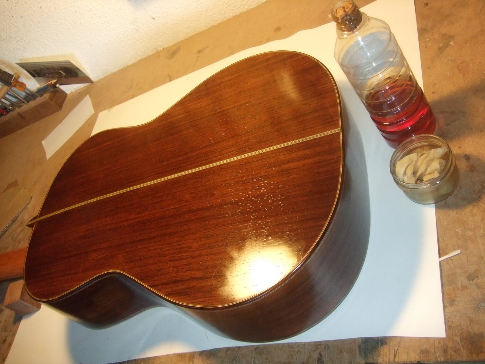

As for polishes, three main routes are
- Polyurethane which is basically a polymer plastic based polish that gives a very high gloss only if the surfacing is done correctly it has shine but no glow.
- French polishing is a wood finishing technique that results in a very high gloss surface, with a deep colour and chatoyancy. French polishing consists of applying many thin coats of shellac dissolved in alcohol using a rubbing pad lubricated with oil through repeated strokes.
- Jugar option is car polish which is usually urethane and not polyurethane, it can be as nice as polyurethane but it's durability properties are different.
In all three, the surfacing will determine the outcome of the polish. Bad surfacing (Majority of readymade handmade furniture in India) will lead to a bad polish. Furniture walas put too much powder and gala and end up making furniture look painted instead of polished and then they call that polish. Also these types of badly polished furniture will start to lose their shine in humidity because it's not really a polish nor a paint but more of a makeshift inbetween.
However I am not an expert on the topic, because my own jamo d830's have a finish I have no clue about or how was done. It does not seem like polyurethane or shellac.
The OP's polish seems like a variant of french polish but i cant say as the thumbnails are pretty small.

by surfacing, you mean sanding and getting it smooth right. any other steps involved? wood is mdf, will be veneered.
@OP sorry this is is semi offtopic but it may be useful for others so writing doors666 reply in detail here, please don't mind.
@Doors
Yes both are readily available and used by furniture polishing people.
And also yes, surfacing is the sanding down and removal of dust/particles on the veneer. Many people wash the veneer as well depending on which wood it is, as some expand too much from washing.
Steps you should take are these
1. Select a veneer with a color and texture which is according to your liking that will not need any kind of color modification. Just a coat of gloss. A good veneer is one with a lot of high contrast texture on it and not just a plain surface like this one below which is veyr boring.
The reason why wiping a moist cloth is important is because a veneer that looks like this at first sight
can reveal a colour like this once polished. Not to this degree but this is just to give you an idea.
Look for a nicely textured veneer. The more the texture, the more beautiful it'll be. Take a look at this image to get an idea of truly beautiful breathtaking wood/veneer known as cocobola/bolo.
2. Now cut a small section of the veneer and get a polisher guy, tell him to polish that piece of veneer. All you want is a coat of high gloss without any kind of added color.
3. Tell him to sand down the veneer along the direction of the texture and not against it. (on the final veneer if he sands it for 10 mins and says it's done, tell him to sand it again. A bad sanding = a bad polish.)
4. Wipe the dust and particles off, place your hand on the veneer surface to check if it's sanded / rough enough. Put on the fan and get rid of the dust in the polishing area.
5. Tell the polisher to proceed and do his mixture and apply it on the piece of veneer.
6. The first coat is usually not glossy, let it dry, sand it gently then apply again, check if gloss has come or not, if not, sand again gently then another coat. This has to be repeated till the desired glossiness if achieved. Each coat risks dust and particles getting stuck in that coat so watch out for that.
7. Approximate cost of polish material+labour should be around 3k.
8. Polish will take at-least 24 hours to dry and is susceptible to dust during that time.
Don't worry about if its polyurethane or shellac or car polish. Just get the polish guy to demo you what he can do on the small demo piece of the veneer first and then go ahead once you've reached a suitable position.
