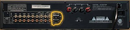

NAD 320BEE has Pre Outs and Trigger inputs and Outputs. Can be used as Pre Amp or an integrated amplifier. These are the specs.

1) What does Mains Out do? It is next to pre outs.

Here you go have fun! check out page 5 - point#9. It is to connect your AV or PA, HT bypass and Pre-Out.

@ssf @chander I did try running the NAD as integrated alone, after getting hold of old wires, but to my surprise super low volume which is barely audible even at full volume on NAD and Activo CT10.
Thought the power amp section is kaput, tried the main out, connected the tube pre amp and it worked properly, tube sound. The Volume is controlled by Tube Pre amp and not NAD.
I guess the voltage Activo CT10 outputing is very less. Though I tried selecting it to 2V.
CT10 > Nad > Q acoustics = no audible sound
CT10 > Tube Pre Amp > Nad > Q acoustics = sound.

Why not connect the NAD to another source and try ? CD / DVD / TV etc. Any setting that is keeping it as a pre.
What are the two pins connecting pre-out to mains-in. Where they connected when you used it as an integrated amp ? 9 & 10 in the manual.
Yes damn those pins :p, I did not connect them while using as an IA. Connected and voala evrything started working.
TV does not have RCAs or 3.5mm Jack's, tried prior with laptop too. Thanks to you got the solution. Mechanical switches :rolleyes:
