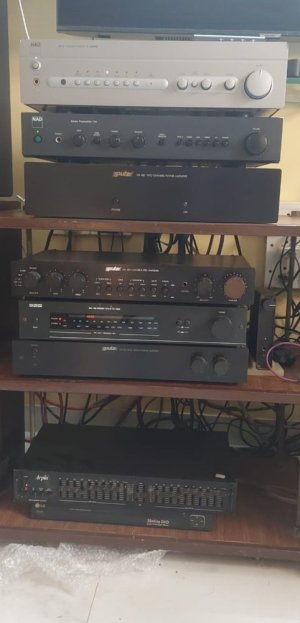

I too now own the NAD 320 BEE .Excellent Amp.Warm Sound Signature .Using it
as a Power Amp with NAD C118 as the Pre Amp.
Currently still playing various types of music to come a final conclusion .
A photograph attached for reference.
