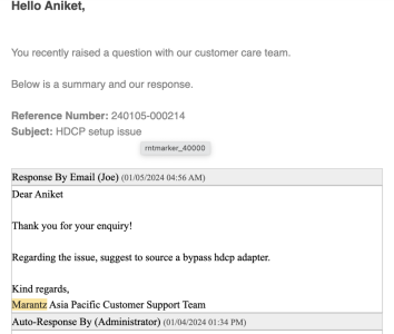

I did write to Marantz customer service and they replied saying get a bypass hdcp adapter. (They wont fix it but will suggest to get an additional unit how cool is that!)
