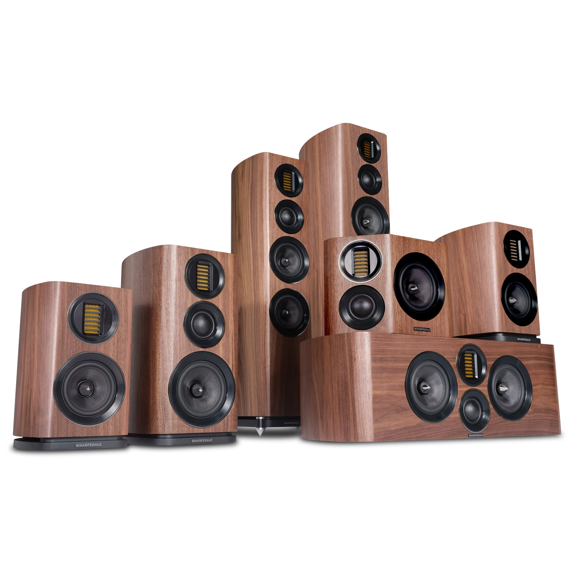

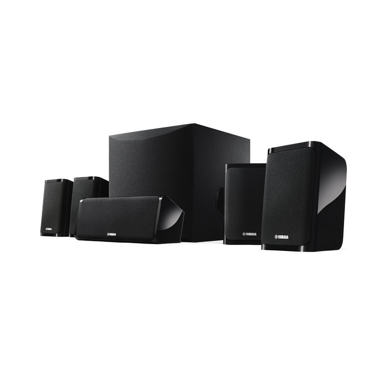

Rates are currently high for new items and hence it becomes a challenge to get what you want with a set budget. Keep a look out online for spot sales from Reliance Digital or Croma or other known dealers.
Pre Owned is the best route now to fulfill your need and use till you can get more budget to invest in something better later...whatever you pick now can be sold later to recover some funds for re investment.
Please visit the seller, do all necessary checks and demo...bargain as much as you can and make the purchase.....some suggestions below....
Entry Level
Next level systems, which are good
Speakers only
