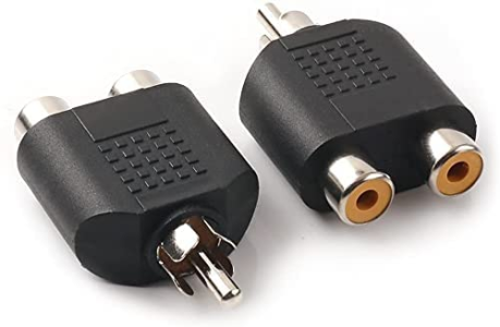

Connect two RCA splitters to both the AUX channels out of your AMP. Connect the existing cable to one of the output of the RCA splitter and connect another pair of RCA cable from the RCA splitter to the subwoofer. I think this is what the guy meant. You can connect either of the below kind of splitter to each channel. You will need two of each
"We have to use 2 x 1 RCA cable to use the LPF control of the subwoofer. The subwoofer pre-out of your amp will be connected with the line in of your subwoofer." This is what they are saying. I don't follow what they r saying

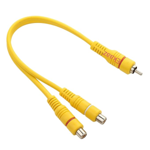

Your amp doesn't have subwoofer pre-out. But it has recording out which also will function like a subwoofer out with full range of audio output. The easiest is what @sandeepmohan has suggested. Just connect a simple left and right RCA cable pair from the recording out of your amp to the line in of your subwoofer.
If your amp didn't have recording out then the only option you would have is to use a one RCA into 2 cable or the MX splitter that I posted.

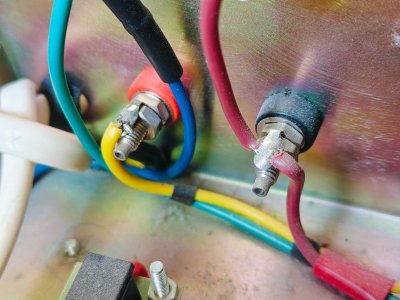

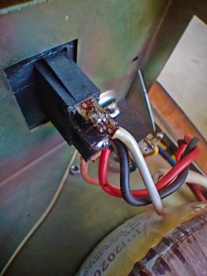

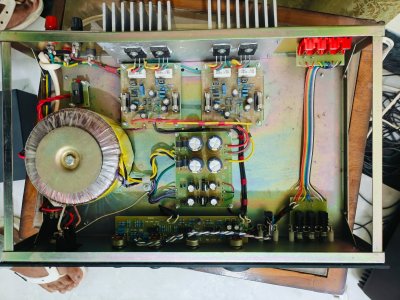

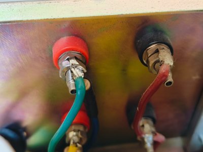

Recently I got my power cable replaced on my amp, but as pointed out by @mbhangui I think the local repairman screwed some of the wiring.
If any one has norge concerto gold amp, Could you please share the image of the internal especially where power cable connects and the ceramic capacitors on the red speaker terminals, so I can match and see what wrong.

The photos were not clear and most probably there is no capacitor on the speaker terminal. A better photo can be found here
It is clear from @Shammi Dang photo that your IEC socket doesn't have a fuse. Did the local repair guy replace your IEC socket too?
Since you mentioned that there was lot of sparking happened inside the amp, you better check the connections on the IEC socket. Maybe the repair guy switched the neutral and earth wires. Also the fuse is missing which can save your amp from such miswiring on the socket side. With a multimeter you should check if there is any connection between the phase terminal and earth terminal and also any connection between the neutral terminal and the earth terminal. Show the photo to Laxman from Norge. He should be able to guide to get the amp connection fixed and have a proper IEC socket with fuse fitted there.
He only replace the power cord and did that in front of me. I'll get in touch with Mr Laxman and proceed upon his recommendation to get it rectified with some proficient local electrician or send it to norge. I unfortunately have no skill when it comes to electrical components
